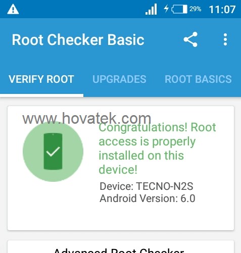

The Tecno N2S (e.g N2S-D2030-A1-M-KE-Safaricom-20160420) is an MT6580 powered phone running on Android 6 (Marshmallow)
How to root the Tecno N2S
Dump your firmware in scatter format using Miracle Box @

Wait till flashing is complete
If you are prompted to fix root, select No
Reboot the phone normally
Confirm Root by installing and running Root Checker @
