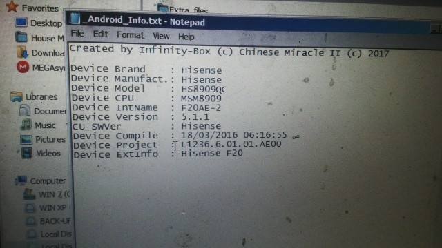

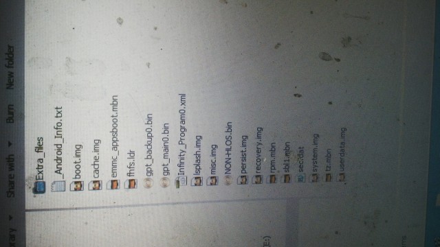

I cant find the required. Xml files qpst needs.. there is only one xml file inside the Rom zip.

(18-08-2017, 04:25 PM)Kenneth.mtika I cant find the required. Xml files qpst needs.. there is only one xml file inside the Rom zip.
Sent from my Z10 using Hovatek mobile
Share a screenshot of the files in the firmware
