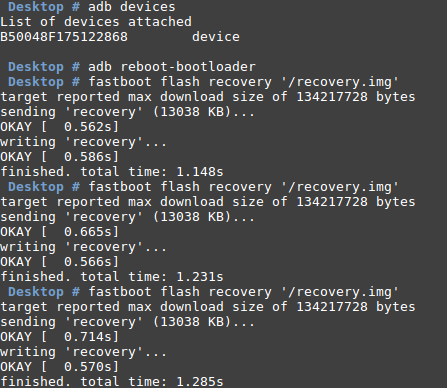

(06-09-2017, 05:55 AM)JuneX05 Here is what i did.
I executed the command you gave
flashed super su and backed up everything in sdcard.
I really do not know why this is happenning but am frustrated already.
The phone doesnot boot to system right now but it boots to recovery and also it charges.. what is the problem with the philz?
did it corrupt the boot
Its not Philz. You would likely get the same with other recoveries.
If it can still boot into stock recovery then get it to Bootloader and relock the bootloader as explained @ https://www.hovatek.com/forum/thread-15863.html
waiting...

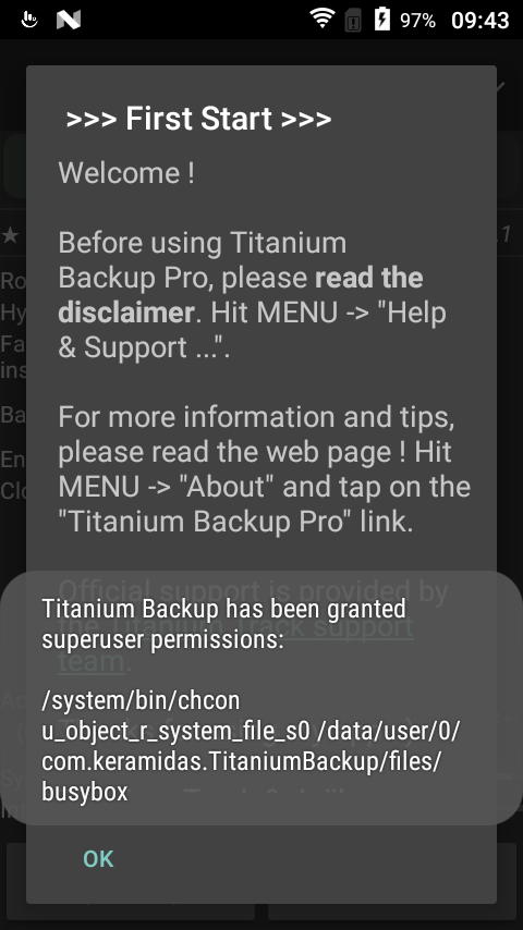

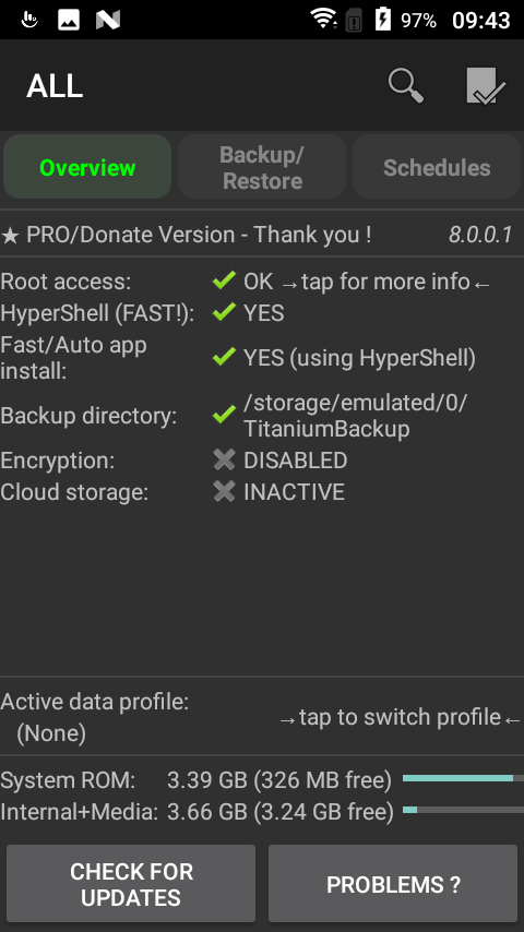

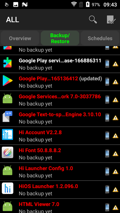

Hello, I think everything is fixed from now on.
The problem was not the recovery,
The recovery is very just fine.... The problem was the super user i downloaded...
I downloaded an update super so it caused the bootloop.
So i downloaded the super user 2.82 latest version and everything.
And now my phone is rooted. All special thanks for not giving up on my careless attitude. Big Grin
Can we now create a guide on how to root this phone though am not sure if the steps are different from any other phone.
......waiting
Below are some of the screenshots showing the root successfull.....
