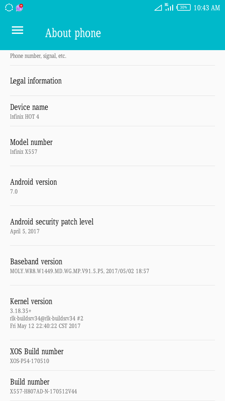

Hello I have tried rooting my Android 7.0 infinix hot 4 but it was not successful below are the process:
1. I flashed the recovery image with the one from the website but what I saw when I boot into recovery mode was different from the normal TWRP Recovery
2. When I was trying to install the supersu.zip file it was not successful.
Below is the screenshot of the my phone version
I will be waiting for ur message or rather reply for further process

Flash the TWRP 3 consecutive times before attempting to boot into recovery.
If stock recovery persists then we'll need to port a custom recovery for your Build.
Dump your firmware in scatter format using Miracle Box @ https://www.hovatek.com/forum/thread-13347.html then upload the scatter and recovery files

(20-07-2017, 07:52 AM)abramobic I have done the above but still remains the same. Pls I need help
Sent from my Infinix HOT 4 using Hovatek Forum
OK.
We'll need to port a custom recovery for your Build.
Dump your phone's firmware in scatter format using Miracle Box @ https://www.hovatek.com/forum/thread-13347.html
Upload the scatter file, recovery.bin, NVRAM, NVdata & Secro
