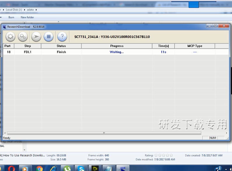

10-07-2017, 11:11 PM
Thank you so much for your swift reply, i really appreciate it. i have used followed all the instructions given, but when flashing its like it only flashes "fdl1" and then says finish I could not attach a video here
Pls I still need your help.

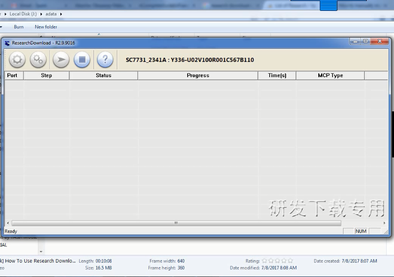

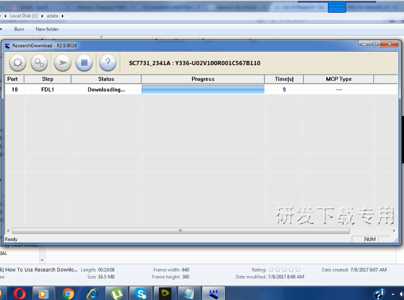

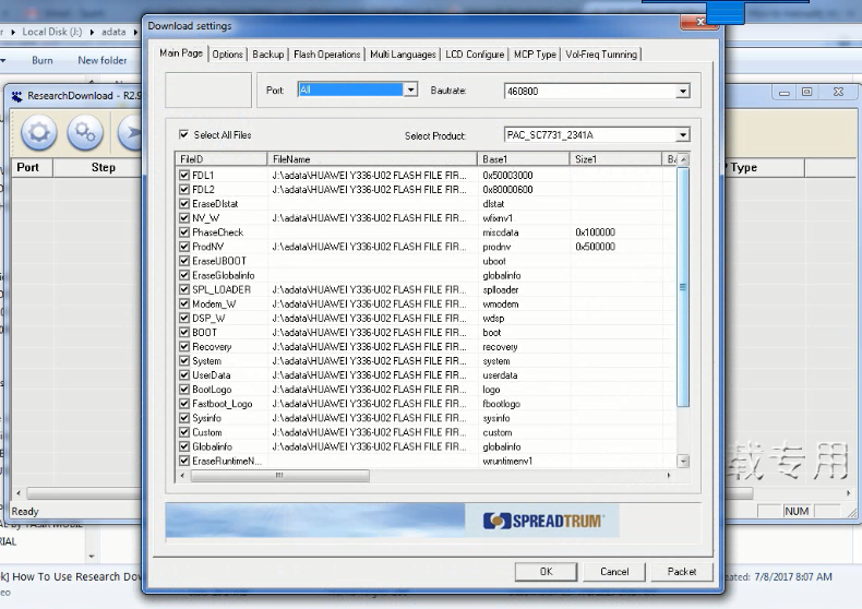

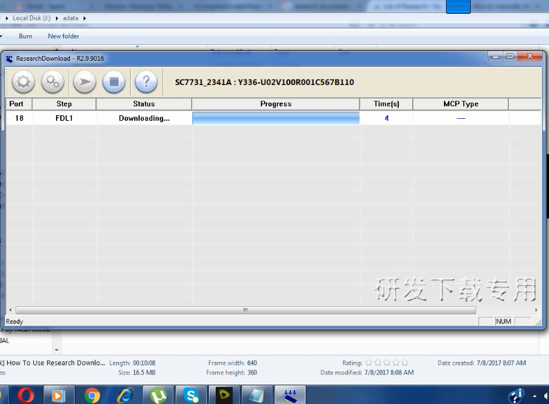

7
14-07-2017, 01:15 AM
Here are the screenshots.

50,934
14-07-2017, 09:18 AM
(14-07-2017, 01:15 AM)shinemicheals Here are the screenshots.
Try using Upgrade Download tool @ https://www.hovatek.com/forum/thread-1231.html

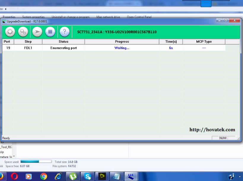

7

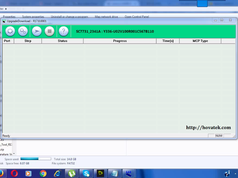

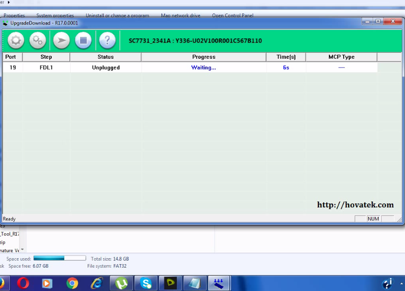

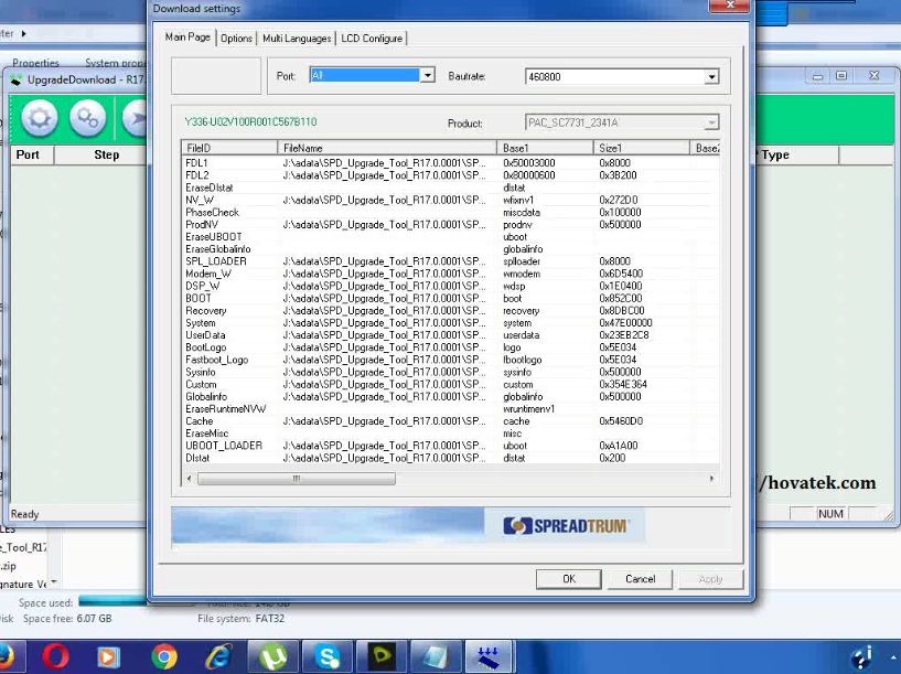

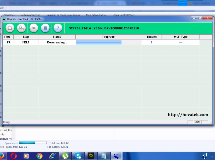

16-07-2017, 12:43 PM
Sir, I have tried the uprade download tool. It was also similar to the result i had before. I have attached the screen shots

50,934
17-07-2017, 01:57 AM
(16-07-2017, 12:43 PM)shinemicheals Sir, I have tried the uprade download tool. It was also similar to the result i had before. I have attached the screen shots
Hope you're holding only Volume down button when connecting and not releasing it immediately after detection .
If yes then you should try another pac file
