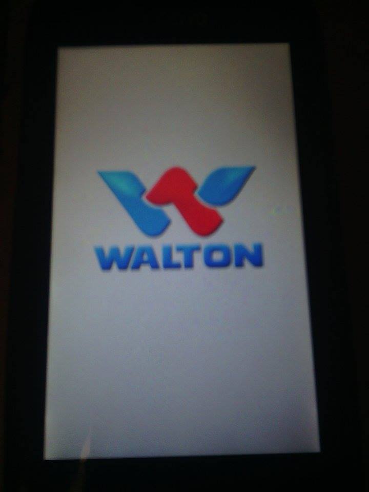

I try to install nexus 1 but doesn't work but keslar work fine.
but Iv v allways nexus logo when I boot my phone. How can I fix it? this's a image...
This post was last modified: 25-11-2014, 06:19 PM by Mcoul15.
50,977
25-11-2014, 10:21 PM
#54
Mcoul I try to install nexus 1 but doesn't work but keslar work fine.
flash logo.bin from stock backup using Sp flash tool
