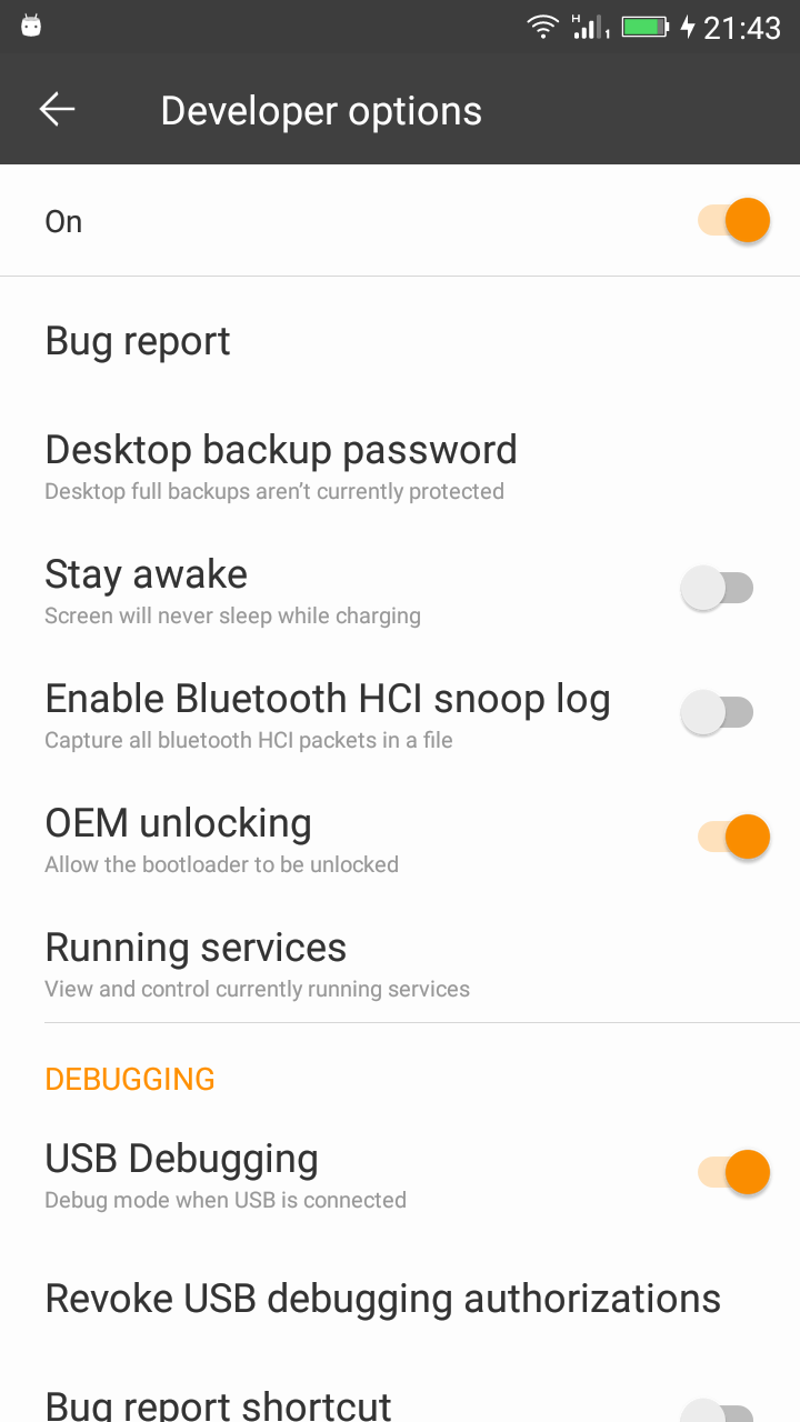

Method 1: Bootloader Unlock Method
There are two main steps:
  • Unlocking the Bootloader of the Gionee Elife S Plus
  • Flashing the Hovatek TWRP recovery.img and SuperSU.zip
Procedure
  1. Download TWRP for Gionee Elife S Plus (Marshmallow) (T8227 & V8441) ported by Team Hovatek @ https://drive.google.com/open?id=0B4S-Z7...lJGMWZGV2s
  2. Download TWRP for Gionee Elife S Plus (Marshmallow) ported by Team Hovatek @ https://docs.google.com/uc?id=0B_-waNKLv...t=download
  3. Setup ADB and Fastboot on the PC using the guide at https://www.hovatek.com/forum/thread-588.html
  4. Extract and copy the TWRP recovery.img into the same folder as the fastboot.exe and adb.exe
  5. Unlock the Bootloader of the Gionee Elife S Plus using the guide at https://www.hovatek.com/forum/thread-14665.html
  6. Download SuperSU 2.76.zip at https://docs.google.com/uc?id=0B_-waNKLv...t=download
  7. Copy SuperSU.zip to both the phone’s SD card and internal storage
  8. Connect the phone to the PC via USB cord while switched On and boot it into Fastboot (as instructed in the Bootloader unlock guide)
  9. When the phone enters Fastboot, load the TWRP recovery to the phone by typing the command below then pressing Enter
fastboot boot recovery.img
  • The phone should automatically boot into TWRP recovery mode
  • In TWRP, if you get a prompt asking you to swipe to allow modification of the System partition, tap KEEP READ ONLY
  • If TWRP offers to root the phone, select NO
  • In TWRP, select backup then backup only NVRAM and Secro. If you end up with Null / Invalid IMEI after rooting, simply restore your Secro and NVRAM backup
  • In TWRP recovery, tap Install
  • Navigate to the location of the SuperSU2.76.zip and select it
  • Swipe to confirm flashing of SuperSU.zip and wait till flashing is complete
  • Reboot the phone normally
  • Confirm Root by installing and running Root Checker

5
18-01-2017, 05:16 PM
need to turn on OEM unlocking before flashing CWM ?
51,059
18-01-2017, 10:11 PM
(18-01-2017, 05:16 PM)iSafeerBinVahid need to turn on OEM unlocking before flashing CWM ?
No, you don't.
That only applies to the fastboot method
