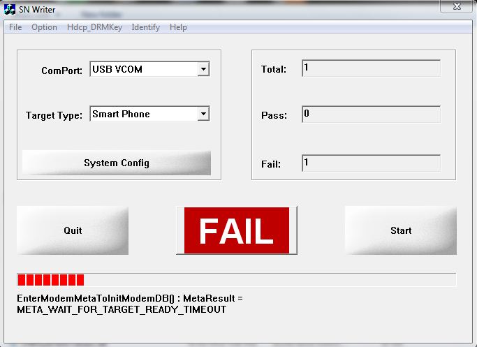

i get this error when am trying to use SN Writer tool
"EnterModemMetaToInitModemDB(): MetaResult=META_WAIT_FOR_TARGET_READY_TIMEOUT"

(08-02-2018, 06:54 PM)KingNebx Okechukwu i get this error when am trying to use SN Writer tool
did you install vcom drivers

(09-02-2018, 10:35 AM)hovatek
Yes i installed the vcom drivers aw it passes te preloader and kernel checks.
Another things is dat since i flash my Gionee f103, i can't seem to see the baseband of the phone again. Even after i flashed the secro again. I don't know if thats the cause.

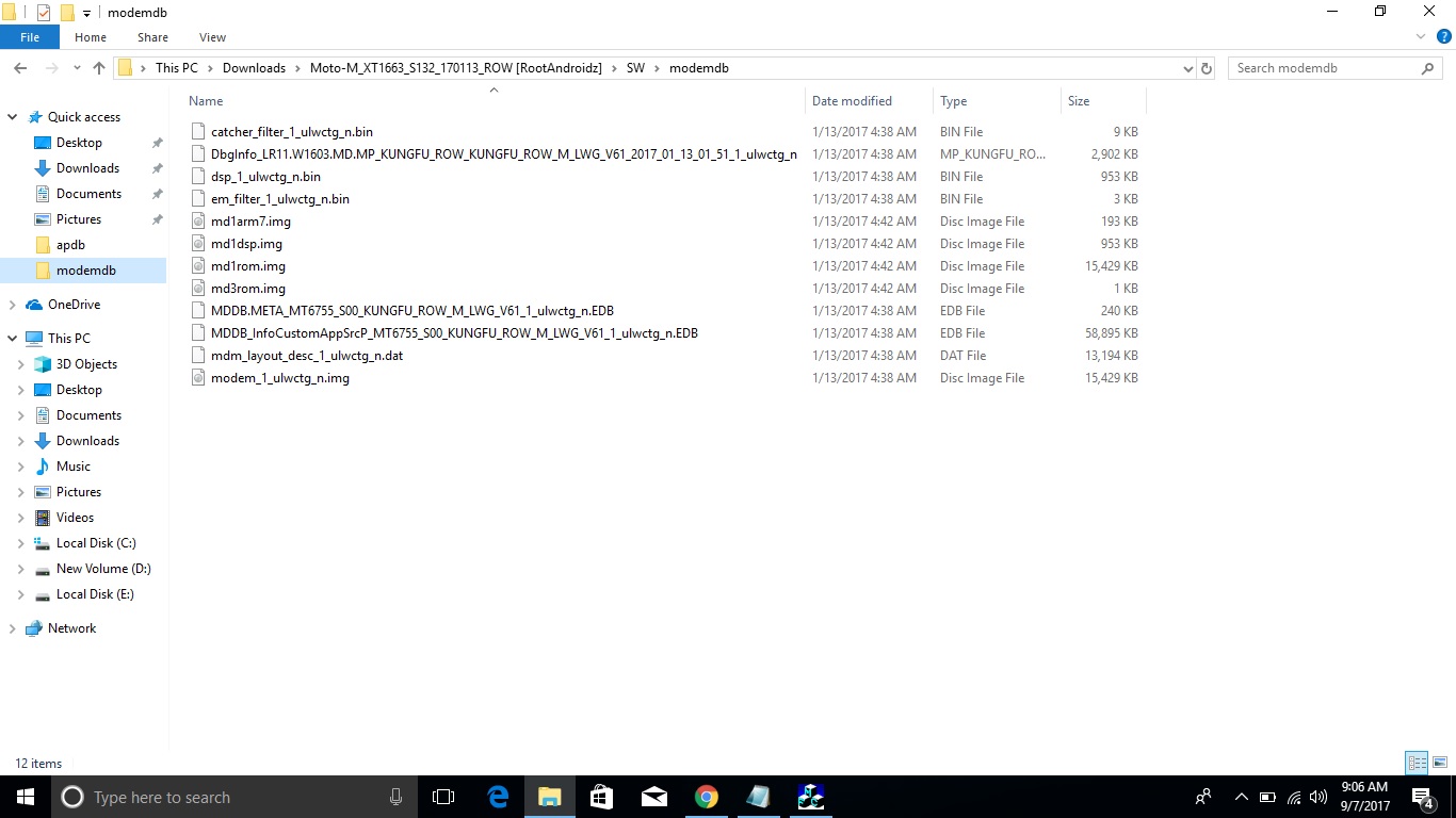

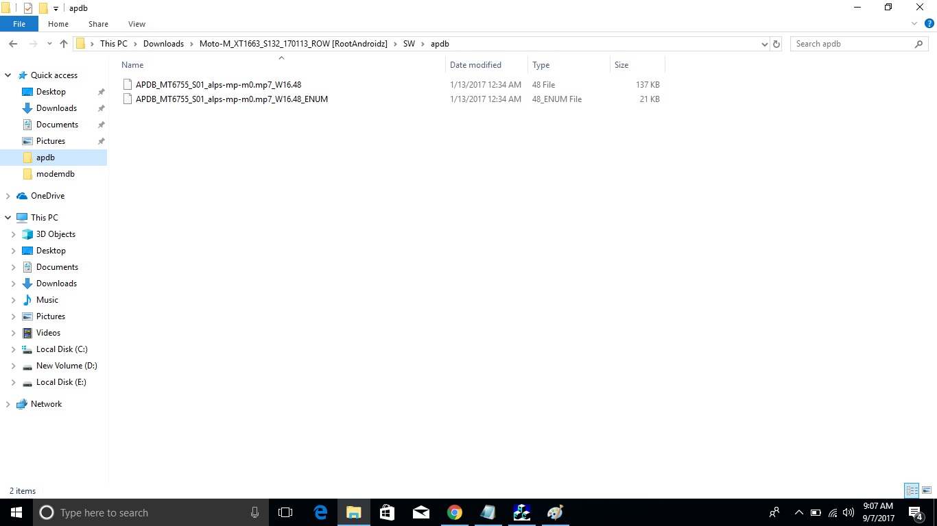

hello sir. how about this? which of these files can be use as my db files? my phone is Oppo A39 MT6750.
