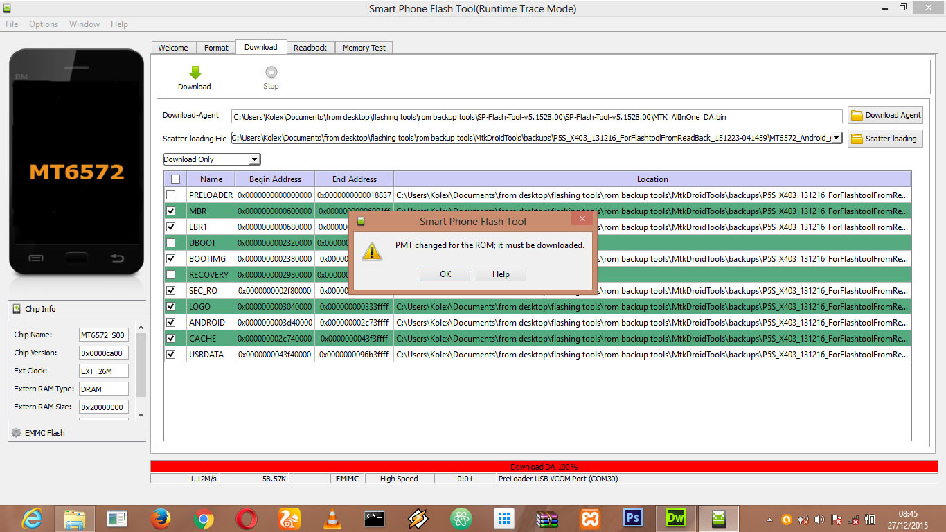

Hovatek, my phone is totally dead (hard brick) i tried flashing my infinix x-403 with the stock rom i backed up form d same type of phone using sp flash tool and MTK droid, when i tried flashing the phone it gives me an error message saying "PMT change for the rom it must be downloaded" pls any help???

Go and format all flash except bootloader

(28-12-2015, 06:03 PM)princey Hovatek, my phone is totally dead (hard brick) i tried flashing my infinix x-403 with the stock rom i backed up form d same type of phone using sp flash tool and MTK droid, when i tried flashing the phone it gives me an error message saying "PMT change for the rom it must be downloaded" pls any help???
format first then flash using SP flash tool @ https://www.hovatek.com/forum/thread-159.html
