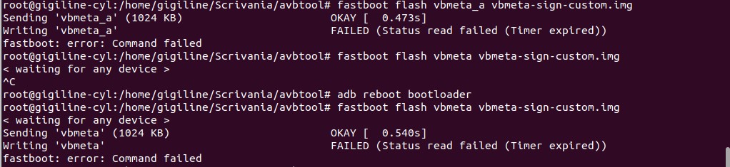

python avbtool make_vbmeta_image --key rsa4096_vbmeta.pem --algorithm SHA256_RSA4096 --flag 0 --chain_partition boot:1:key/key_boot.bin --chain_partition dtbo:6:key/key_dtbo.bin --chain_partition socko:13:key/key_socko.bin --chain_partition odmko:14:key/key_odmko.bin --chain_partition vbmeta_system:2:key/key_vbmeta_system.bin --chain_partition vbmeta_system_ext:3:key/key_vbmeta_system_ext.bin --chain_partition vbmeta_vendor:4:key/key_vbmeta_vendor.bin --chain_partition vbmeta_product:5:key/key_vbmeta_product.bin --chain_partition l_modem:7:key/key_modem.bin --chain_partition l_ldsp:8:key/key_ldsp.bin --chain_partition l_gdsp:9:key/key_gdsp.bin --chain_partition pm_sys:10:key/key_pm_sys.bin --chain_partition l_agdsp:11:key/key_agdsp.bin --chain_partition l_cdsp:12:key/key_cdsp.bin --padding_size 20480 --output vbmeta-sign-custom.img
Same for me, i have create vbmeta custom (stock img flash without with this command: fastboot flash vbmeta_a vbmeta.img) but with this not flash, is stock on WRITING:, i have see dimension of custom vbmeta and is 20kb, the stock is 1mb, i think the problem is this, any solution?

17-08-2022, 05:53 PM
(17-08-2022, 04:51 PM)Gargoyle
(16-08-2022, 11:41 PM)gigiline ... i have see dimension of custom vbmeta and is 20kb, the stock is 1mb, i think the problem is this, any solution?
python vbmeta_pad.py
now get this error

18-08-2022, 08:21 AM
(17-08-2022, 05:53 PM)gigiline
now get this error
Reboot device to fastbootd,
adb reboot fastboot
