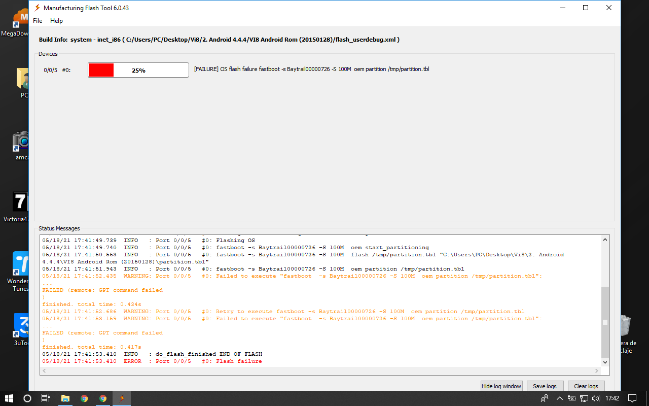

I load the flash_userdebug.xml file to install android on my Chuwi Vi8 tablet and it always gives me an error when it reaches 25% of the installation. It has all the necessary drivers installed, therefore if the program recognizes the device when I connect it.
I also attach the .log file where it is shown when the installation error occurs.
# Manufacturing Phone Flash Tool Logs generated on 2021-04-25T09:52:11
#### Flash tries 1 ####
#### Flash failure 1 ####
#### Flash success 0 ####
#### Fail IFWI 0 ####
#### Fail ENUM 0 ####
#### Fail Modem 0 ####
#### Fail OS 1 ####
04/25/21 09:48:49.131 INFO : Manufacturing Flash Tool V 6.0.43 (build on Sun May 18 12:29:29 PDT 2014)
04/25/21 09:48:49.260 INFO : Loading settings from C:/ProgramData/INTEL/Manufacturing Flash Tool.ini
04/25/21 09:48:49.289 INFO : Using Qt version: 4.8.1
04/25/21 09:48:49.289 INFO : Using XFSTK version: 1.5.5.
04/25/21 09:48:49.315 WARNING: Please select a flash file...
04/25/21 09:48:58.636 INFO : Loading Flash file (C:/Users/PC/Desktop/Vi8/2. Android 4.4.4/VI8 Android Rom (20150128)/flash_userdebug.xml)
04/25/21 09:48:58.636 INFO : GP_Flag is set to 0x80000045
04/25/21 09:48:58.636 INFO : Ready to flash!
04/25/21 09:50:17.639 INFO : do_new_medfield_device STARTING TO FLASH
04/25/21 09:50:17.640 INFO : Port 0/0/5 #0: DNX/droidboot phase - SN : Baytrail00000726
04/25/21 09:50:22.808 INFO : Port 0/0/5 #0: Booting to droidboot.img success - SN : Baytrail00000726
04/25/21 09:50:54.844 INFO : Port 0/0/5 #0: Flashing OS
04/25/21 09:50:54.845 INFO : Port 0/0/5 #0: fastboot -s Baytrail00000726 -S 100M oem start_partitioning
04/25/21 09:50:55.650 INFO : Port 0/0/5 #0: fastboot -s Baytrail00000726 -S 100M flash /tmp/partition.tbl "C:\Users\PC\Desktop\Vi8\2. Android 4.4.4\VI8 Android Rom (20150128)\partition.tbl"
04/25/21 09:50:57.082 INFO : Port 0/0/5 #0: fastboot -s Baytrail00000726 -S 100M oem partition /tmp/partition.tbl
04/25/21 09:50:57.570 WARNING: Port 0/0/5 #0: Failed to execute "fastboot -s Baytrail00000726 -S 100M oem partition /tmp/partition.tbl":
FAILED (remote: GPT command failed)
finished. total time: 0.425s
04/25/21 09:50:57.825 WARNING: Port 0/0/5 #0: Retry to execute fastboot -s Baytrail00000726 -S 100M oem partition /tmp/partition.tbl
04/25/21 09:50:58.304 WARNING: Port 0/0/5 #0: Failed to execute "fastboot -s Baytrail00000726 -S 100M oem partition /tmp/partition.tbl":
finished. total time: 0.417s
04/25/21 09:50:58.570 INFO : do_flash_finished END OF FLASH
04/25/21 09:50:58.570 ERROR : Port 0/0/5 #0: Flash failure

Are you certain you downloaded the right firmware? What's the present condition of the tablet?
