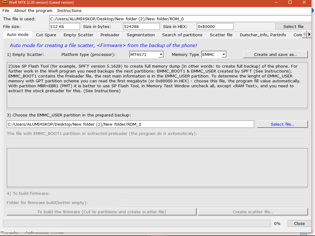

Hello hovatek moderators and gurus in d the house, I have been having dis difficulty for a long time now, it goes thus;
Whenenver I want to perform ram test in rom dumping using wwr tools always give me dram flip test,I was told to use mtkdroid tools but I noticed mtkdroidtools no longer works on newer chipset, so I was told again to use wwr and sp flash tool using pgpt file, so dis it;

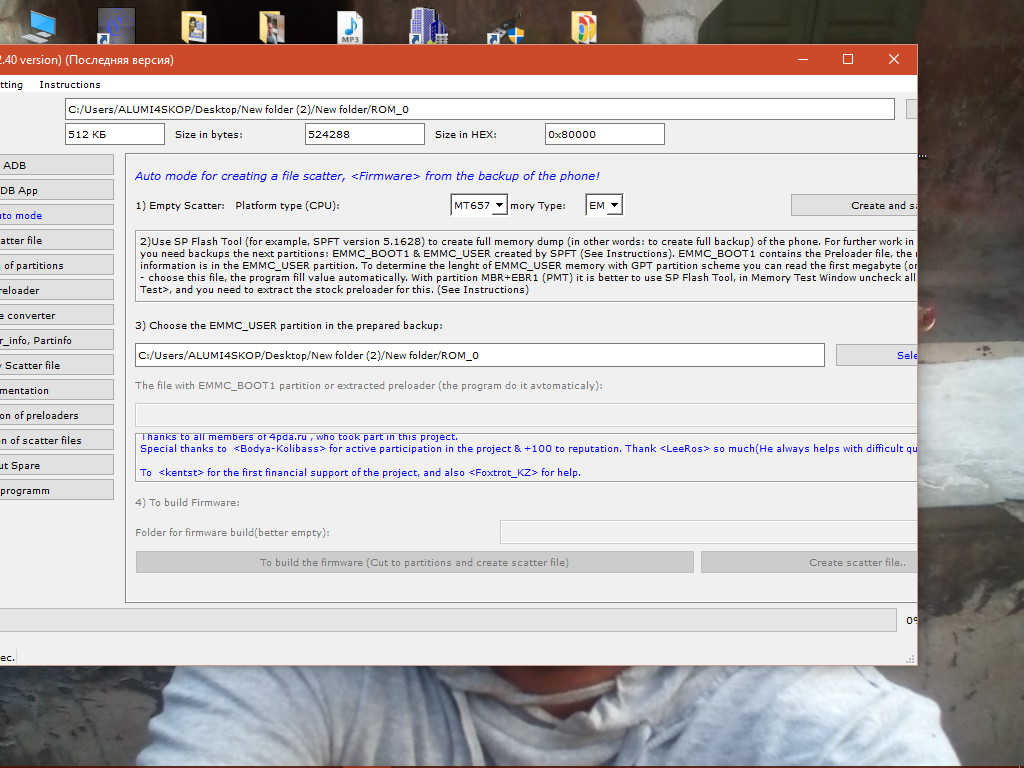

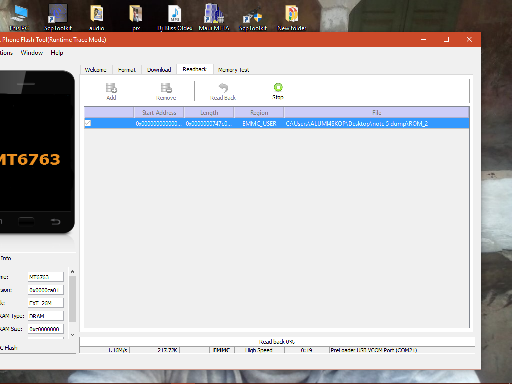

After creating a scatter file for my chipset in wwr , though I have d normal scatter file downloaded from hovatek but what if I don't have access to normal scatter file,can't I use my own scatter file to start afresh , so I created a scatter file using wwr in regard to my phone chipset mtk6763 I.e infinix note 5,after creating d scatter file ,I move onto spflash tool to perform a readback , so I ticked and perform a readback with emmc_user and d address no being told like 0*0 and d physical start of 0*80000,and I perform a successful feedback of rom_0 of like 512kb , went back to wwr ,I selected d select file which is my rom_0 but nothing happens , as in I will post a screenshot of my PC screen ,I tried on wwr 2.30 and wwr 2.40 ,I need this badly so as not to bother hovatek every month for boot.img for my phone cos I receive update every month , its an android one cos of d security patch( who send dem), so pls gurus in d house come to my aid

if your model has scatter file on our individual firmware list, you can use that to begin or you can create one using wwr. any one you go with is fine
attach this PGPT file of yours here lets take a look, also note that PGPT is on emmc_user not on emmc_boot1
if you read 0x80000 from emmc_boot1 you'll get preloader instead of PGPT, try doing another readback just to be sure you read from emmc_user

Yea I did create a empty scatter txt using wwr using create scatter file in the scatter tab with regard to my chipset type mt6763,though I have scatter file for my chipset with full partition details here in hovatek but I decided to use my home created in wwr (what if I don't have access to scatter file here b4,wont I do it), here are d details and of course I use emmc user in d spflashtool feedback options start address and length is 0*0 and 0*80000 respectively, see above

your readback is good, load it up in wwr
updated the guide at https://www.hovatek.com/forum/thread-22701.html for PGPT files such as yours, check the end section of the guide
dumping 32GB will take a really long time, so if you want to skip usedata [to reduce the dump size and time]
switch to 'scatter file' tab
copy and use the address under FINISH for system_b partition

Pls wait here, pls , d issue is dat, we perform a ram test so as to get physical length address so as to backup various partition in wwr, but i can't see any address here in regards to wwr video i downloaded here using wwr and notepad++ and spflash tool to make a full from dump, pls explain in simple English for me to understand so as to teach fellow room mates, to me i can't see dat address in the rom_0 stated above, i open it in wwr , i can't see anything there like d one in dat tutorial video biko, pls i can't ask boot.img everytime here na, abi na me dey buy bandwidth for u guys here, pls biko
