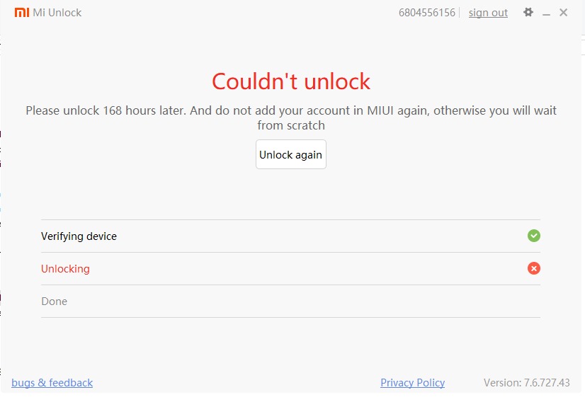

I turned off the phone and booted into Fastboot mode by holding down Power + Volume Down until the Fastboot mode logo showed up, I connected the device to the PC, and launched the Mi Unlock Tool, logged in with my account. It detected my phone just fine. I hit “Unlock,” only to be greeted with this message:
“You need to wait 168 hours before unlocking your device.”
Yep. 168 hours. That’s 7 whole days. No option to skip. No workaround. Just a hard wall.
Here’s the kicker: if I logged out of my Mi account or reset the phone, the countdown would reset. So I basically turned my Redmi 10A into a sacred relic, didn’t touch anything I didn’t absolutely need to. I even avoided switching from mobile data to Wi-Fi because some people online reported issues.

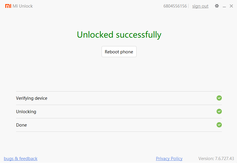

Finally the wait was over. I ran the Mi Unlock Tool again, and this time, it just… unlocked in less than 5mins. No drama. No additional error messages. Just a clean success.
And that was it. Bootloader unlocked.
