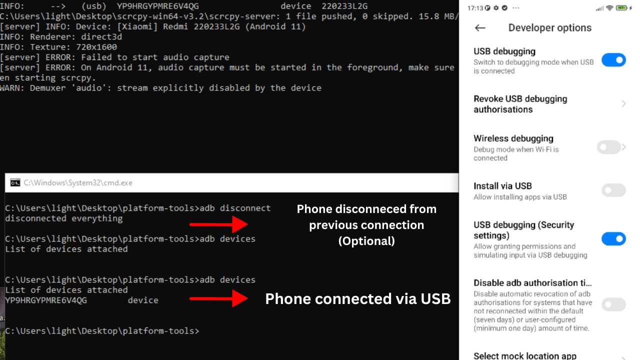

Running scrcpy via USB
I ran the adb disconnect command to end the wireless connection. Then, I connected my Redmi 10A and launched the GUI version of Scrcpy.
adb shell 4
The phone’s screen appeared instantly on my PC, fast, smooth, and fully controllable. Note that you won’t be able to control the device with Scrcpy unless USB debugging (including the security settings) is enabled.
No extra setup needed
  • Just connect to your Redmi 10A wirelessly using the ADB commands we discussed earlier.
  • Run Scrcpy and enjoy seamless remote control of your device.
