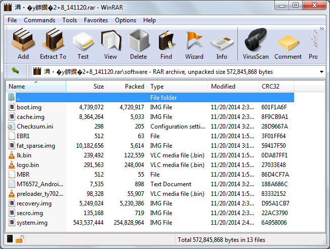

everything was sent in a rar file so i am now trying to extract the contents of the rar file using winrar but other files will extract except system.img and I have downloaded this twice incase there was download error but still same error. or can it be used without extracting it?
the prev image i uploaded did not include the winrar menu i just captured the region that contained the files. I was not trying to open the system.img directly just wan to extract it from the rar archive

(24-12-2014, 08:18 PM)4jean everything was sent in a rar file so i am now trying to extract the contents of the rar file using winrar but other files will extract except system.img and I have downloaded this twice incase there was download error but still same error. or can it be used without extracting it?
try using 7zip to extract

I use 7 zip it stops at 99 percent says
Header error
There are some data after the end of the payload data
data error software/system.img

(24-12-2014, 11:58 PM)4jean I use 7 zip it stops at 99 percent says
Header error
the person needs to re-pack the files and resend. ensure he repacks.
