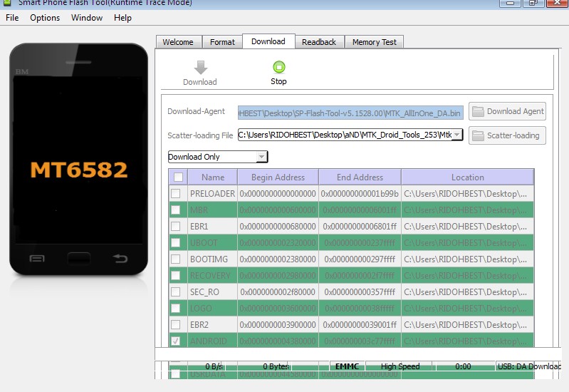

after the 'pmt change rom, it must be downloaded' error, then i try format and upgrade firmware, then anoda error msg prompt 'PRO_INFO: Fail to get pmt info

(22-10-2015, 08:58 AM)ridohbest after the 'pmt change rom, it must be downloaded' error, then i try format and upgrade firmware, then anoda error msg prompt 'PRO_INFO: Fail to get pmt info
Use download only and do not tick any box that has an empty path unlike others

how many files will i untick because when i try the download only, i only tick the file name 'android' bt still not successful

(22-10-2015, 03:49 PM)ridohbest how many files will i untick because when i try the download only, i only tick the file name 'android' bt still not successful
load the scatter files then click download (do not connect the phone)
let me see a screenshot of SP flash tool at the point

the screen shot is in the attachment

That's the screen shot

(23-10-2015, 12:12 PM)ridohbest That's the screen shot
All looks in order.
Click format at the top. Dont use format all + downlad and don't use firmware upgrade

i can help you with this first make it download only after finish make it framewere it must work with you good luck bro

Thanks. Your advice here just saved me.
