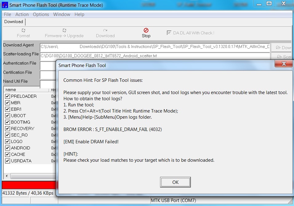

hi I have my alcatel ot Idol 6030x and it's dead no sign of life except for the deep blue light on the upper left part when i connect to pc. I used SP FLASH TOOL V3.1244.0.sn85 and download the s4clone stock rom. i format it first(except bootloader) green circle pop up "OK". then i Download first the preloader.bin and got this: BROM ERROR: S_DA_SDMMC_WRITE_FAILED(3149)
then I use SP FLASH TOOL V5.13.52. format it first(except bootloader)and I have this: BROM ERROR: S_PART_NO_VALID_TABLE(1037). then download preloader.bin still same error.BROM ERROR: S_DA_SDMMC_WRITE_FAILED(3149)
my device manager doesnt show "DA VCOM PORT", only "mtk usb port". but when i run flash tool, before it shows error, "mtk usb port" loose connection and replace by "DA VCOM PORT" for 1-5 seconds loose on the device manager I say it because it appears on the lower right part of the sp flashtool. hope you can help me.

do you have the stock ROM for your exact phone model? and if you do, list the files in it
