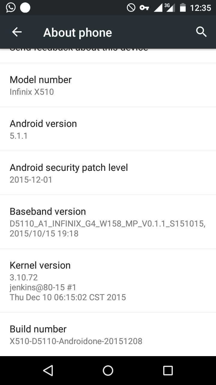

I flashed d recovery image successfully using so flash tools but when I press volume up and power button to boot into recovery mode, I will see infinix and then see Android and it will start normally. I used adb to flash d twrp IMG in fastboot mode bit it didn't still work. Any solution
Kernel version3.10.72. jenkins@80-15

(27-12-2015, 12:35 PM)ifeskilz I flashed d recovery image successfully using so flash tools but when I press volume up and power button to boot into recovery mode, I will see infinix and then see Android and it will start normally. I used adb to flash d twrp IMG in fastboot mode bit it didn't still work. Any solution
With this image,  booting into twrp using button combo wont work.  You need to boot into recovery using an app like rashr
