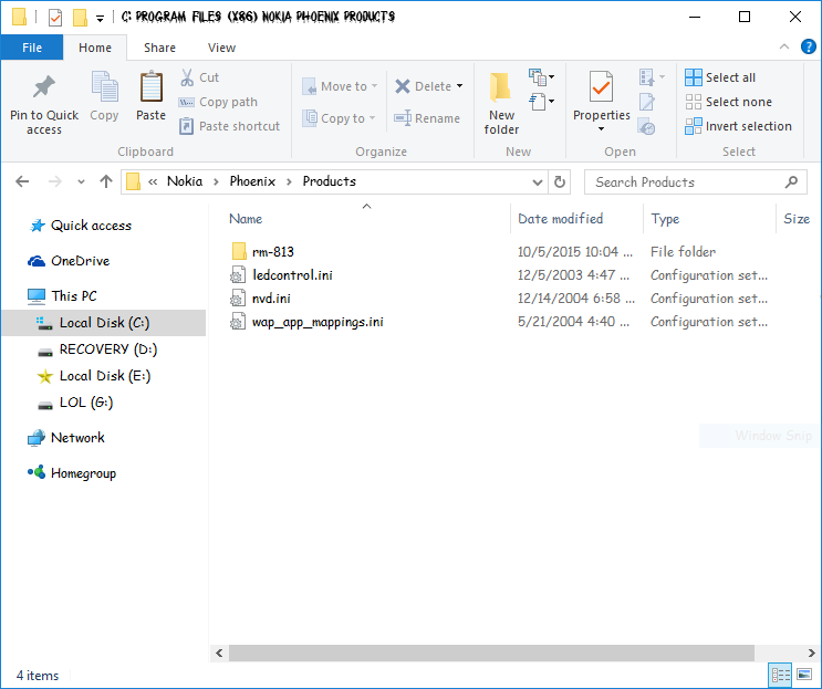

  1. Navigate to C:\Program Files (x86)\Nokia\Phoenix\Products
  2. Create a folder inside the directory above and rename the folder to your phone's product type. E.G Nokia asha 302 should be renamed as RM-813
    [Image: attachment.php?aid=1362]

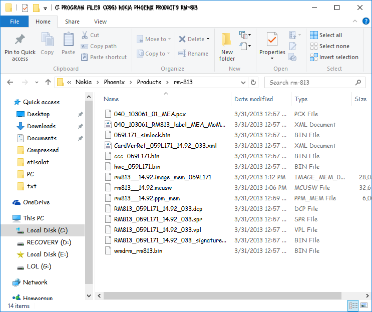

  3. Copy and paste all downloaded files into the newly created folder. use the picture below as reference

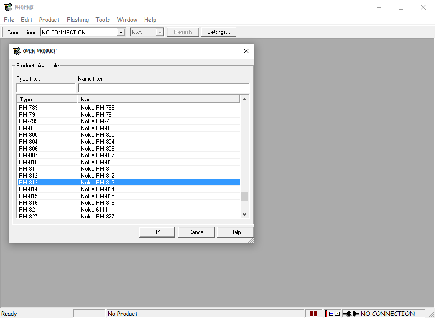

  7. Click File > Open Product.
  8. Select your RM code from the window that appears. Click OK (see pic below)
     NOte: for asha 302, we'd select RM-813

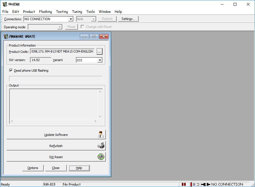

  9. Click on the Flashing tab > select Firmware Update. (see pic below)
    [Image: attachment.php?aid=1365]
  10. Check the option “Dead Phone USB Flashing”
  11. Click the small box beside product code and select your phone's firmware (see pic below)
    [Image: attachment.php?aid=1366]
  12. Click SW Reset and the phone reset process should start.
