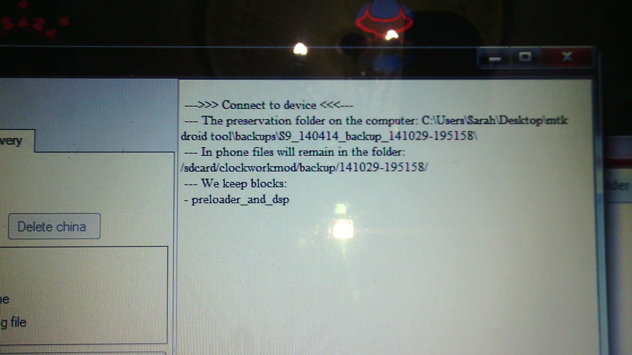

01-11-2014, 10:27 AM
Hi,I tried to backup my working phablet and mtk droid tool always stuck at preloaded and DSP_BL.
It's stucks there for hours!!!can anyone tell me what is the cause??I need the ROM dump to unbrick my device.pls help.thks

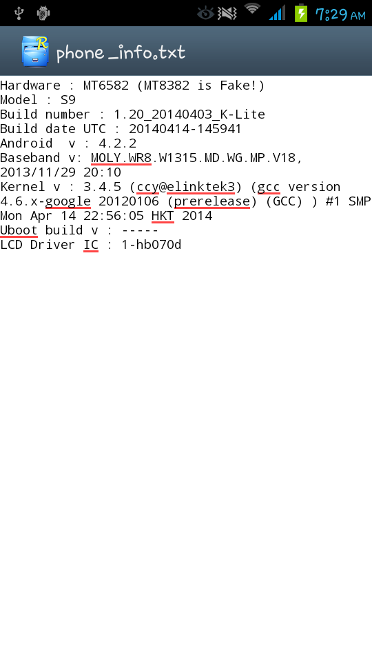

01-11-2014, 10:38 AM
specs attached
