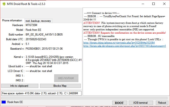

I am following the tutorial on using MTK Droid Tool to make a backup (thread-468). Please look at the attached screen-shot. (The Rook by EE phone is a carrier-branded ZTE Blade A410 btw). Three questions please:
1. the tutorial says that I should get a yellow box next to the PHone details, but the box is blue, as you can see. What does this mean? Is it a problem?
2. In the thread with the list of errors, it says that if I get the "TotalBytesPerChunk ...." error, that I should check that an SD is inserted. One **is**inserted. Could it be faulty? Also, you say to install BusyBox -- There are many many different BUsyBox installers in the Play store. Does it matter which one I install?
3. In the thread with the list of errors, it says that if I get the "SU is inaccessible" errror that i should ensure that the phone is rooted. Well, this phone is NOT rooted, I am hoping to use the tool to flash a rooted ROM, but first I want to take a backup of the stock ROM that is on my device. will this allow me to do that?
sorry for such beginner noob questions. I appreciate your help

create a new thread for this

Done:
https://www.hovatek.com/forum/thread-11610.html
If appropriate, plz remove this post and the previous two from this thread.
