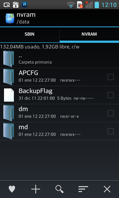

Install ROM Toolbox Lite or any good Root browser. next, using the root browser, open data > nvram folder then list all what you see there

17-09-2014, 04:26 PM
Here is the list of the folder

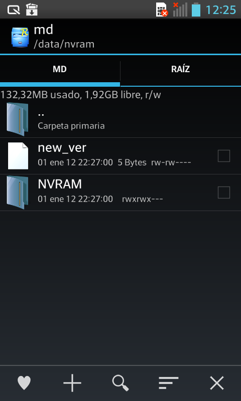

Open the md folder and lets see what it contains

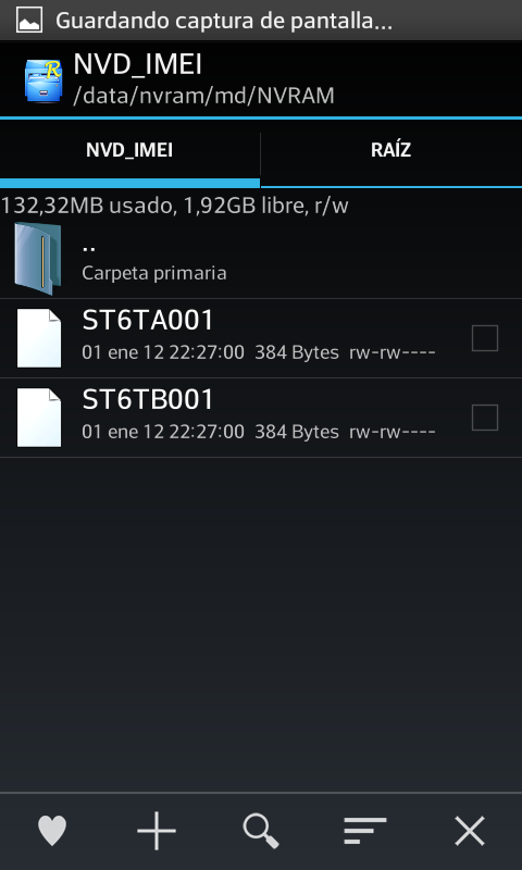

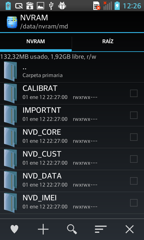

19-09-2014, 04:29 PM
There it is all the folders you explain in the tutorial

19-09-2014, 05:49 PM
(19-09-2014, 04:29 PM)onilink90 There it is all the folders you explain in the tutorial
MP0B_001 file is missing in the NVD_IMEI folder. create it as the tutorial explains then place it there. grant permissions 777 to the file

15
19-09-2014, 06:08 PM
I understand all but I dont know how to grant permissions 777 to the file? and the other two files are displayed there in the nvram ?? I have to do something with that?
This post was last modified: 19-09-2014, 06:13 PM by onilink90.
51,035
19-09-2014, 07:40 PM
(19-09-2014, 06:08 PM)onilink90 I understand all but I dont know how to grant permissions 777 to the file? and the other two files are displayed there in the nvram ?? I have to do something with that?
leave the other two the way they are. to set permission, long press the file then select permissions. tick all 9 boxes and save
