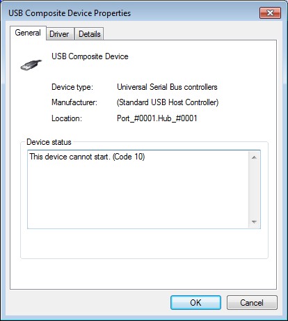

The Code 10 error is one of several Device Manager error codes. The Code 10 error will almost always display in the following way:
"This device cannot start. (Code 10)"
Details on Device Manager error codes like Code 10 are available in the Device Status area in the device's properties
Important: Device Manager error codes are exclusive to Device Manager. If you see the Code 10 error elsewhere in Windows, chances are it's a system error code which you should not troubleshoot as a Device Manager issue
Cause of the Code 10 Error
A Code 10 error is generated when Device Manager can't start the hardware device, a situation usually caused by outdated or corrupted drivers. A device may also receive a Code 10 error if a driver generates an error that Device Manager doesn't understand. In other words, a Code 10 error can sometimes be a very generic message indicating some kind of unspecified driver or hardware problem.
