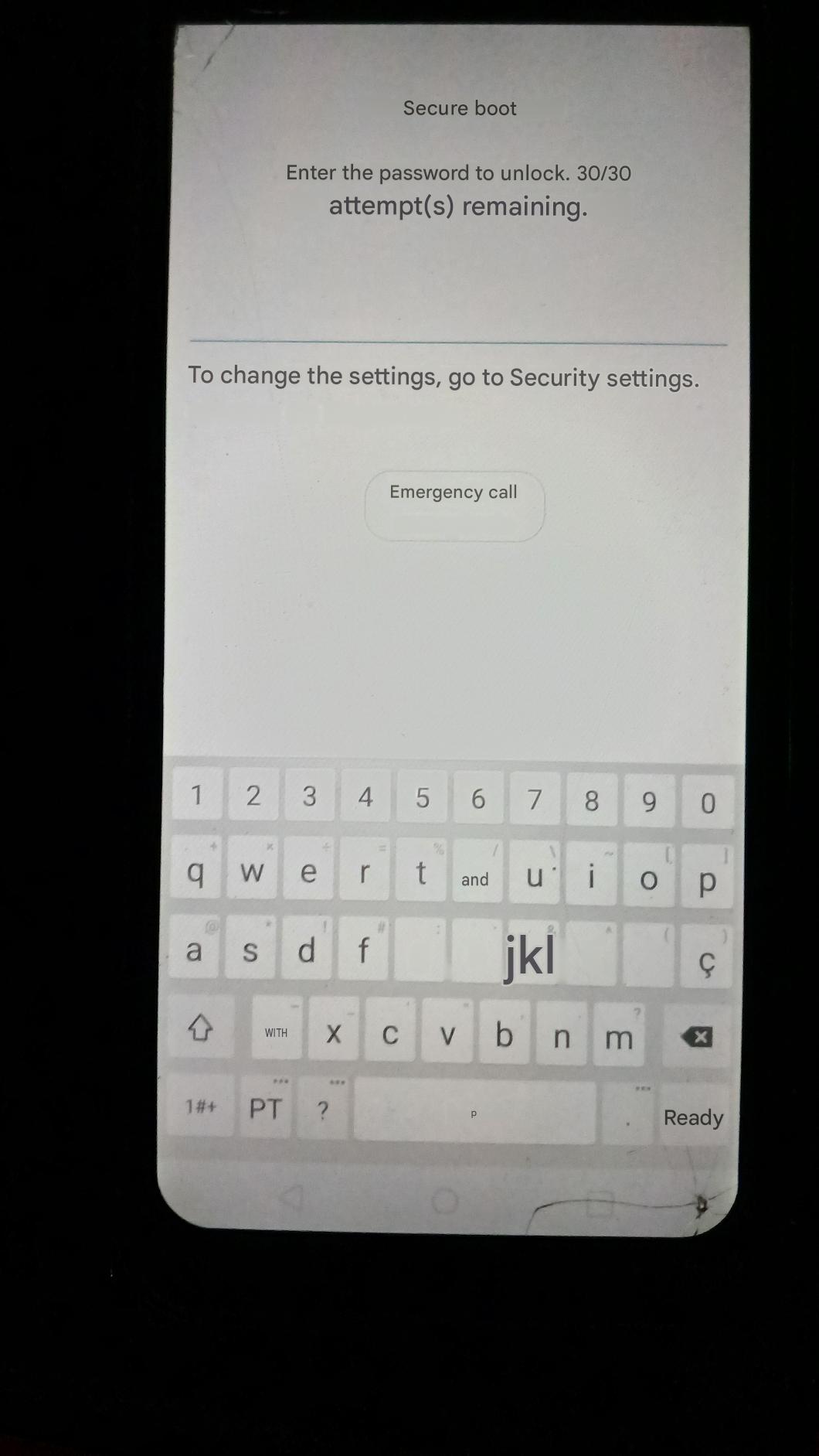

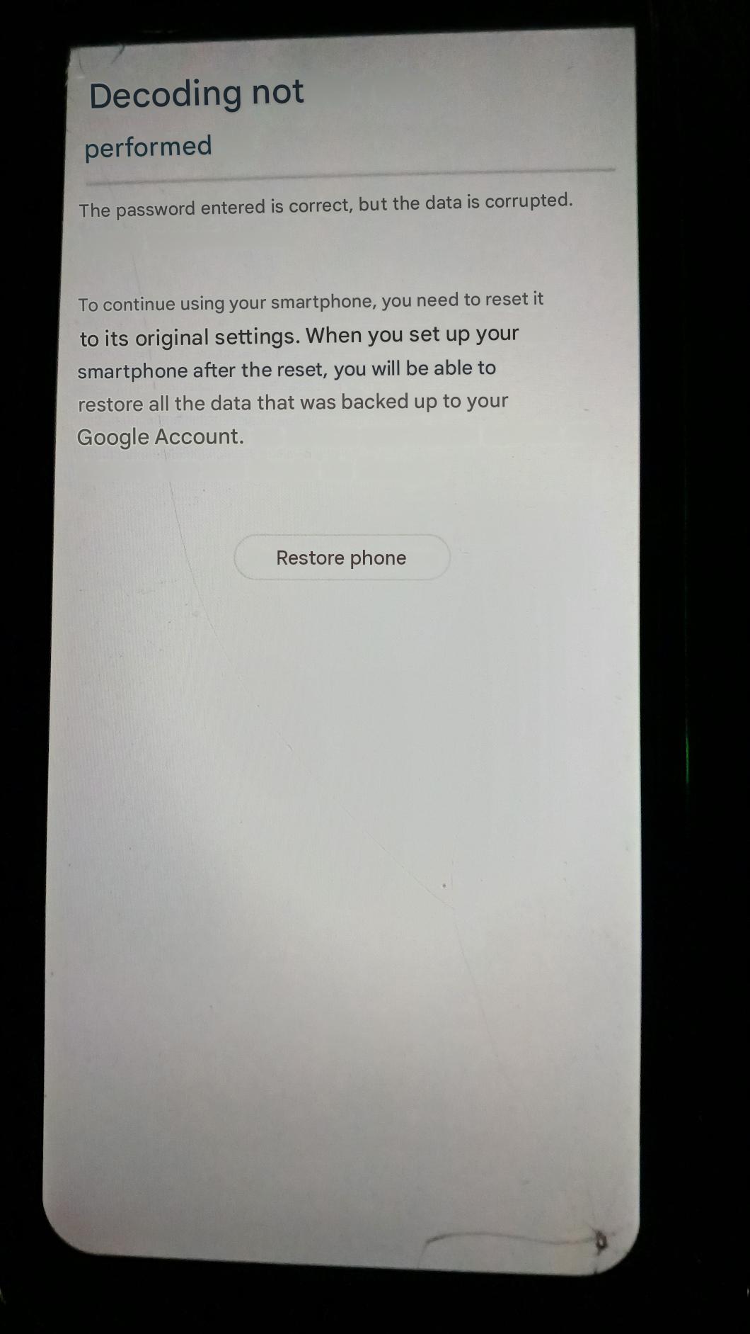

After installing this on my active slot, it boots fine into a safe password, that I don't know but any password will tell its right but requires a wipe, after the restart, it keeps on a bootloop

Share a picture of the screen showing the password mode.
You should have tried fastboot boot first instead of fastboot flash.
Anyway, fixing it isn't a problem. You just need to get into bootloader, then flash the stock boot image.
Alternatively, you could use SP flash tool.
This post was last modified: 23-08-2026, 11:23 PM by hovatek.

24-08-2026, 02:11 AM
(23-08-2026, 11:19 PM)hovatek
(23-08-2026, 10:36 PM)True_Gamer4959 After installing this on my active slot, it boots fine into a safe password, that I don't know but any password will tell its right but requires a wipe, after the restart, it keeps on a bootloop
https://ibb.co/5Wkt5Rv1
https://ibb.co/ZpRwtCKQ
Also this phone and other cheap LG phones don't have fastboot
I'm using mtkclient instead
30-08-2026, 06:41 AM
(24-08-2026, 02:11 AM)True_Gamer4959 heap LG phones don't have fastboot
it says:
Quote:Decoding not performed
The password entered is correct, but the data is corrupted.
To continue using your smartphone, you need to reset it to its original settings. When you set up your smartphone after the reset, you will be able to restore all the data that was backed up to your Google Account.
Restore phone
Quote:Secure boot
Enter the password to unlock. 30/30 attempt(s) remaining.
To change the settings, go to Security settings.
You either do a factory reset or flash back the stock boot.img so you can move important stuff.
This post was last modified: 30-08-2026, 06:44 AM by hovatek.

31-08-2026, 05:55 PM
(30-08-2026, 06:41 AM)hovatek
it says:
Restore phone
already did that, then when it reboots, it wipes data, like if that modified boot file couldn't do this
Also shouldn't the boot file be like 40mb? like the original file
