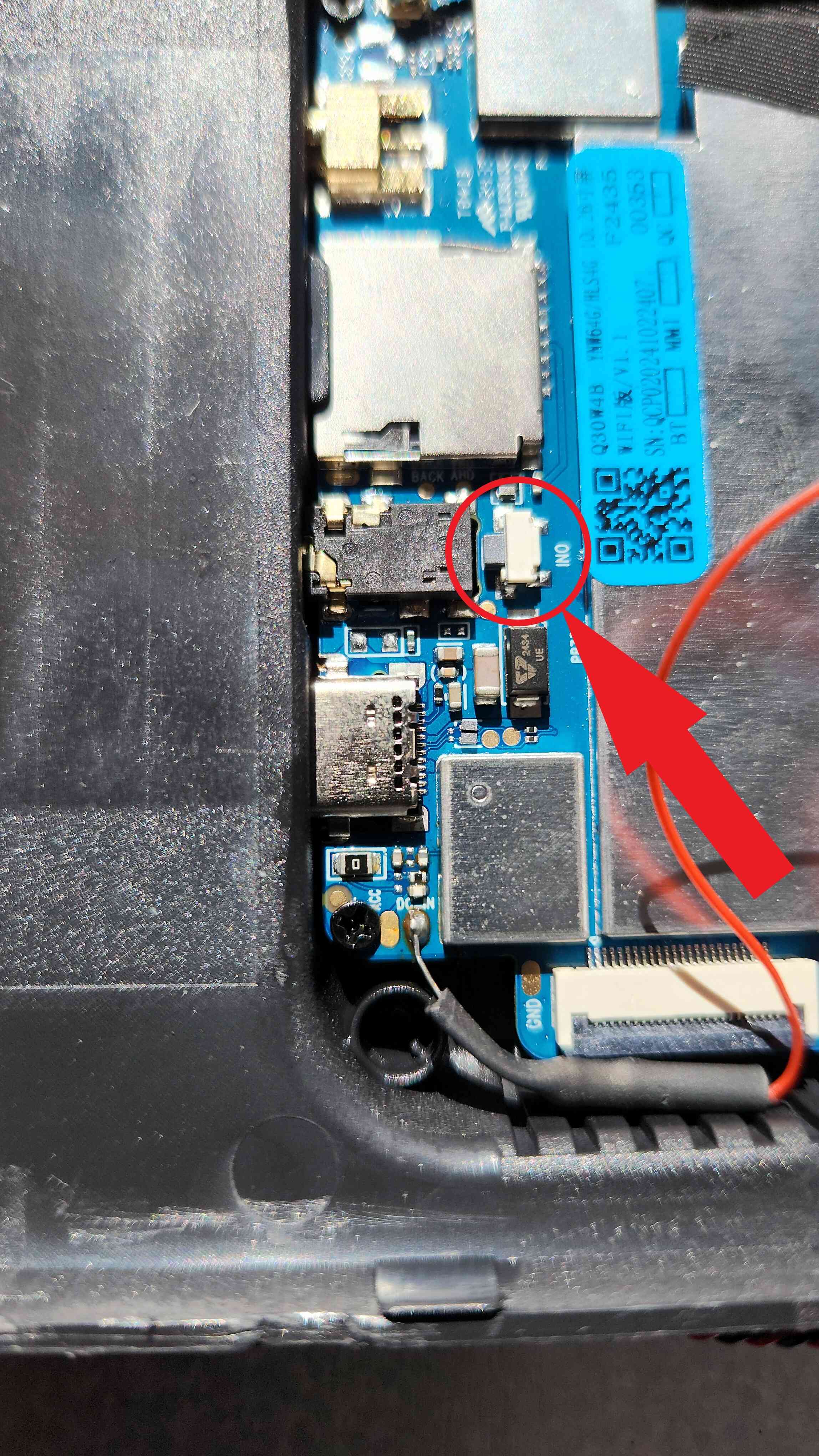

My mistake was - because the device (it's portable Android car screen, UMS9230, T606, 4GB RAM, 64GB ROM) has no other physical keys, only power button on the side and reset button on the back (pinhole), I had to find pad on pcb, which would allow entering into download mode. I thought I found the correct pad, the device was being recognised as SPRD U2C DIAG on COMx when plugged in, but it was disconnecting after about 5 seconds and rebooting into Android EVERY time.
I have realised later, that it wasn't correct pad to trigger DOWNLOAD MODE or BootROM.
There was in fact button that I initially misidentified, right behind jack socket, where you would plug in reversing camera (see photo).

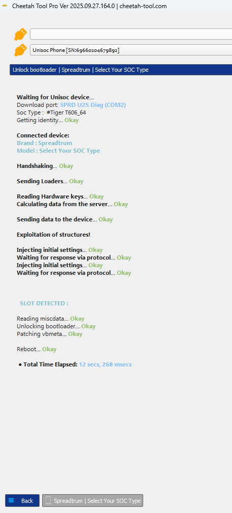

After finding out, I confirmed it was the correct button to trigger download mode, using Cheetah Tool Pro I successfully unlocked Bootloader on first try.
From there I was able to backup all partitions using Cheetah Tool Pro.

And I thought I'll try flashing only patched boot_a and boot_b. Flashed only boot_a_patched.img first into slot a using fastboot. Then reboot and boOom! All works.
No need to fiddle with vbmeta, signing etc!
Finished rooting with Magisk app on the device. After that, for peace of mind flashed boot_b_patched.img into slot b, rebooted, confirmed that all works.
