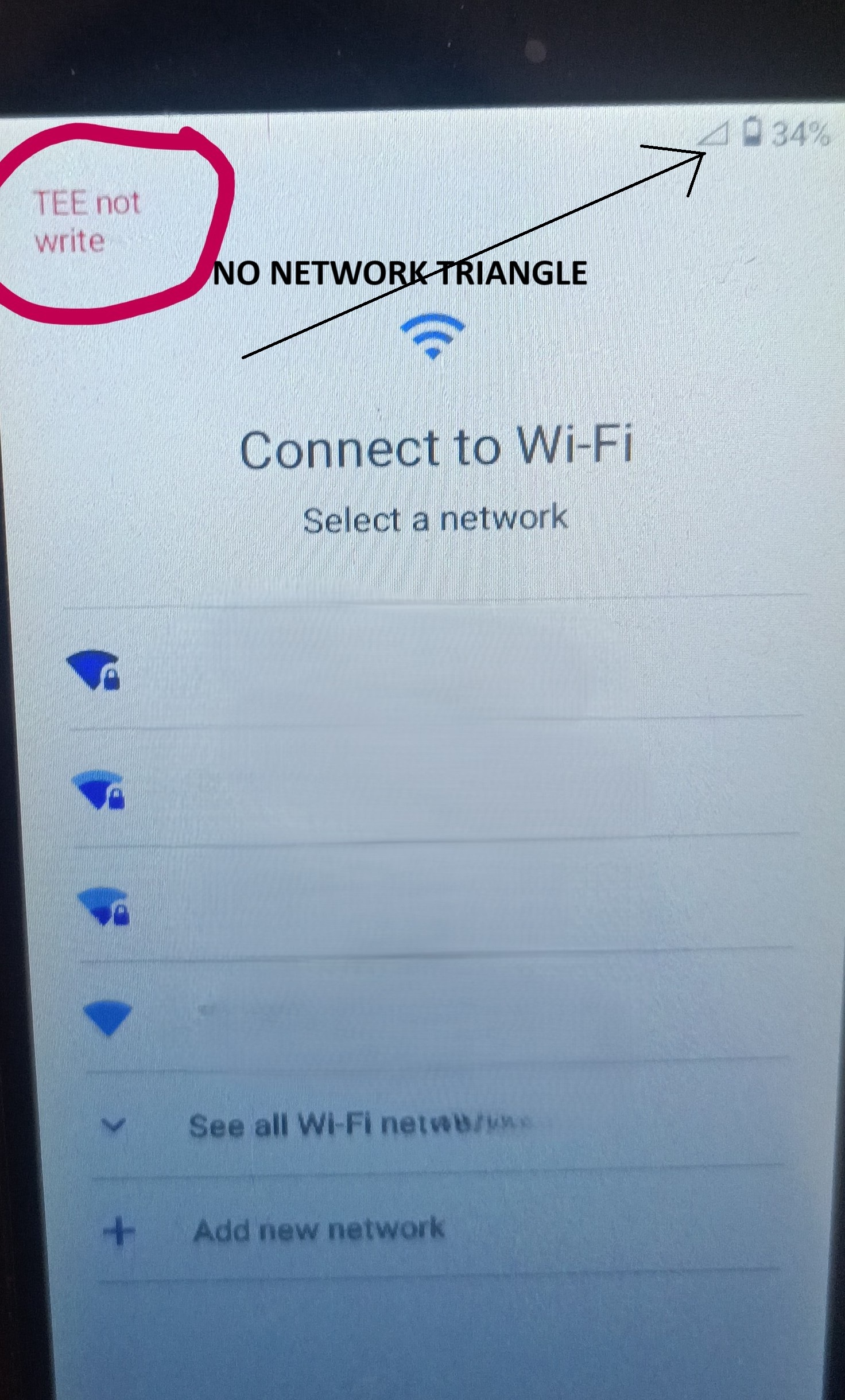

How to solve the error SIM CARD PERMANENTLY LOCKED, TEE not write?
I will appreciate all assistance provided,
Phone: Neon Smarta 2
Processor Unisoc SC9832E
Android 14

What actions were taken on the phone before the error occurred?

Thanks,
Removing sim lock, and mdm
using gsm shield dongle

Have you flashed back the factory firmware?
Did you backup security files during the process?

I do not have the factory firmware

Run this command and share the output
adb shell pm list packages
