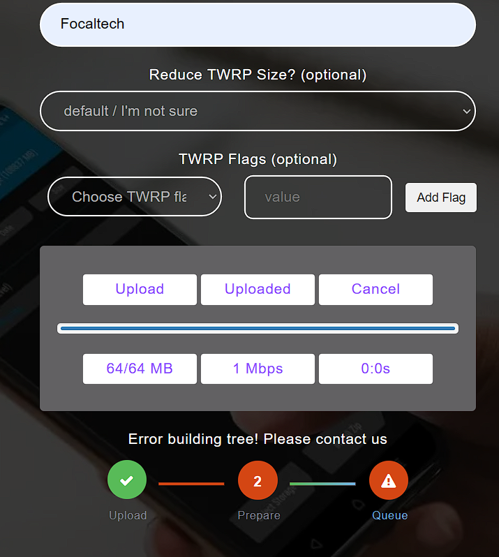

In Online TWRP builder it's showing, "Error building tree Please contact Us", What do i do?

(12-02-2025, 09:13 PM)SaturoGojo In Online TWRP builder it's showing, "Error building tree Please contact Us", What do i do?
Share link(s) to the image(s) you uploaded at the tool.
Also any of the following (in the firmware:

(15-02-2025, 01:39 AM)SaturoGojo Here's the link https://www.hovatek.com/forum/attachment.php?aid=12028
I'm asking for:
recovery.img
boot.img
vendor_boot.img

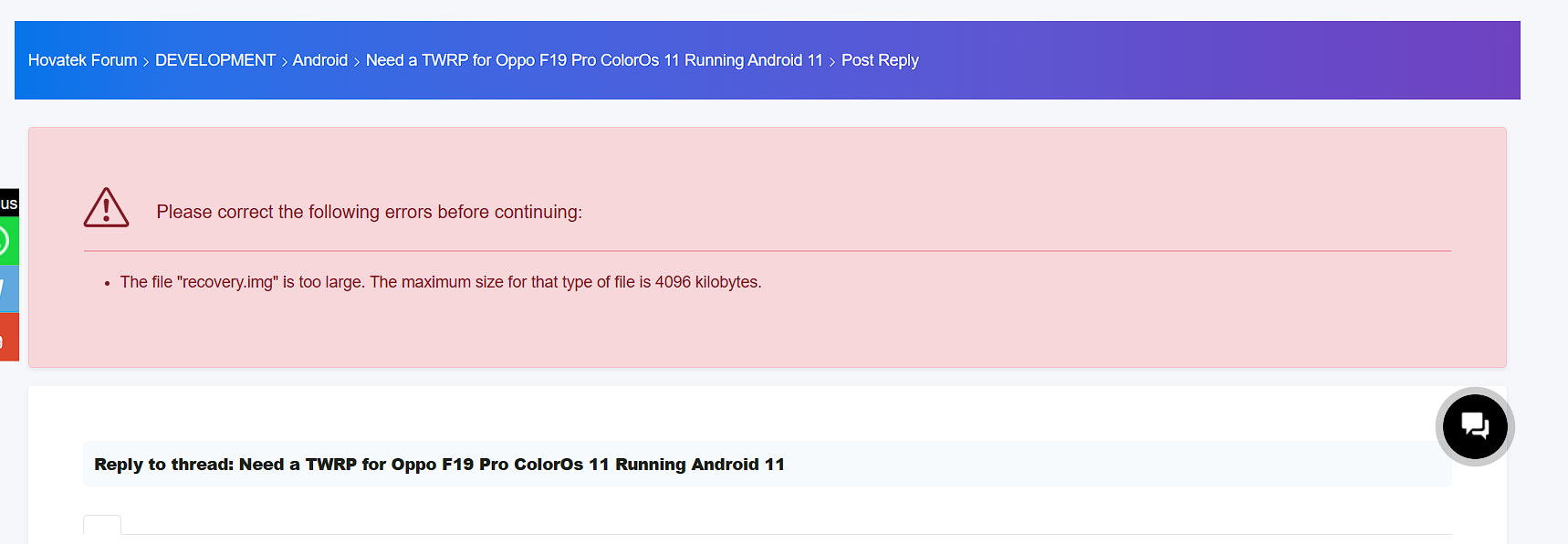

The uploader is giving this error

Can't upload any image cause all of my stock img file is large, I couldn't upload it. When i try to upload the .img file it gives the error file too large, pls HELP i am waiting for too long. I am giving an SS of the error that is showing.
51,022
20-02-2025, 08:40 AM
(19-02-2025, 05:51 PM)SaturoGojo Can't upload any image cause all of my stock img file is large, I couldn't upload it. When i try to upload the .img file it gives the error file too large, pls HELP i am waiting for too long. I am giving an SS of the error that is showing.
Upload the files to services like Google drive, Mega, Mediafire etc and drop the links here

(20-02-2025, 10:08 AM)SaturoGojo Here's the link to Mega. Pls let me know if u need anything else.
The problem was your recovery.img.
I had to:
1. Unpack the recovery.img
2. Copy the contents of ramdisk/vendor/build.prop to ramdisk/prop.default
3. Repack the recovery.img
4. Upload it at the tool
WorkID: Fiexb5xZewx1MfxLMHe7
