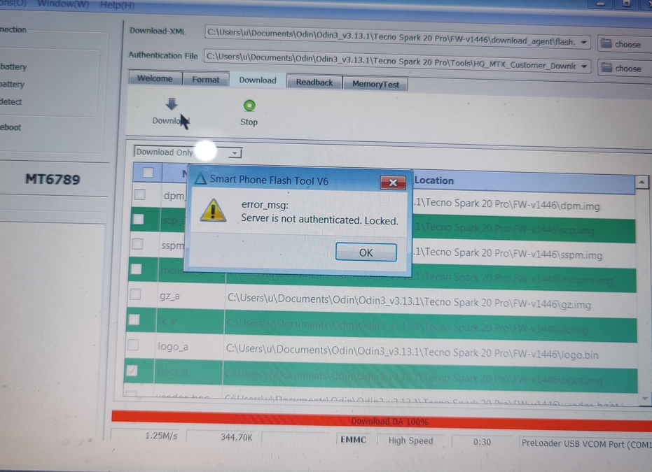

Hello friends, i have this device with mediatek mt6789. I flashed a recovery into the boot partition (instead of booting) and now it's stuck in bootloop without access to fastboot.
I tried all kind of tools among them spflash tool. I loaded the stock firmware and the sv5 auth file but i'm getting "create com file failed" how can i fix this.?

Use key combo to boot the TWRP and copy your stock boot to the phone and also the TWRP with the following cmd
adb push name of image.img /sdacard
And from TWRP u can install back boot to boot partition and flash TWRP as ramdisk

You'll need a paid tool to flash
