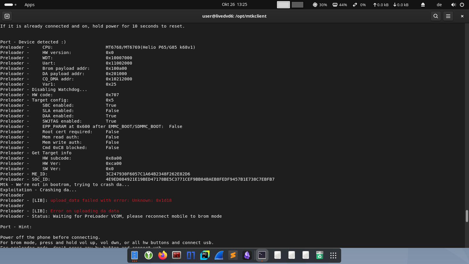

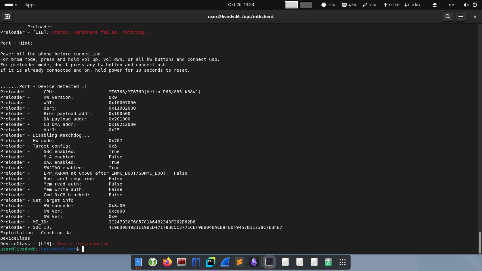

Hi Sir,
          My phone is dead now after flashing Modified Ik.img to remove orange state error and 5 sec delay. I read and watch your instructions to perform this. I have done all perfect. But after flashing lk.img, my phone was unable to turn on, even it's not showing Infinix Logo, not able to boot into reovery or fastboot. I'm stuck. I tried disable auth programs but nothing worked, i tried using mtkclient it also showing error. Please help me to recover me phone. it has very important data in it.
Here is the article i followed:  How to fix MTK orange, yellow & red state warnings
My device is Hot 30 g88

Did you backup firmware before flash?
Try using SP Flashtool V6 to flash back stock IK.img

You clearly need to revert to stock LK. WHich method did you use to flash the modified LK?
Try this command
python mtk.py payload
