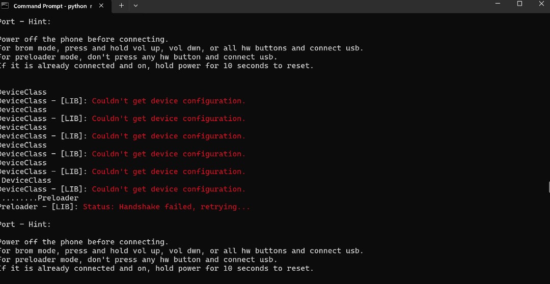

please help my tecno bf7 is on red state and keeps rebooting i dont know the build number, when i tried flashing a boot.img file i keep getting error.. have attached the error i get from mtk client tool

(22-10-2024, 09:18 PM)suleiman please help my tecno bf7 is on red state and keeps rebooting i dont know the build number, when i tried flashing a boot.img file i keep getting error.. have attached the error i get from mtk client tool
Is the device bootloader unlocked?
31-10-2024, 08:58 AM
Try this command
python mtk.py payload
If it fails then either BROM exploit is patched or it requires an auth file
