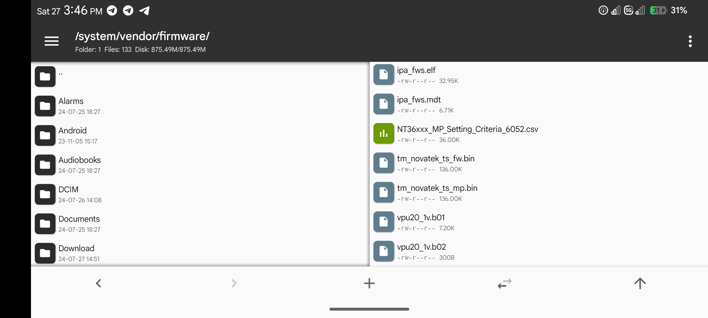

Use a root file manager to check the vendor > firmware folder or system > vendor > firmware. Share a screenshot of the contents

27-07-2024, 11:18 AM
There are so many files . But I think the driver file are in screenshot, check ✔️

(27-07-2024, 11:18 AM)igamer1150 There are so many files . But I think the driver file are in screenshot, check ✔️
Copy out the two novatek files and upload then drop the link
