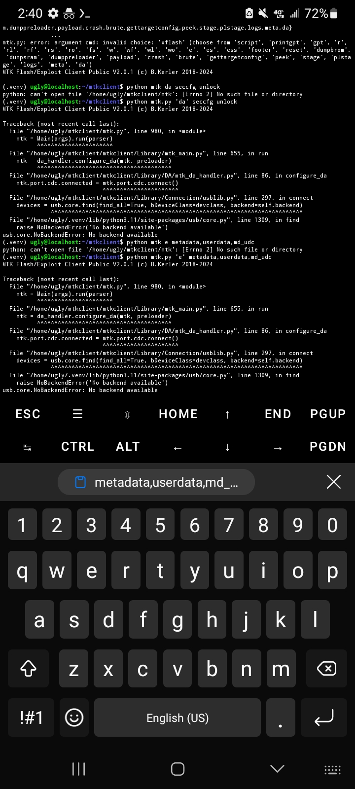

Trying to unlock bootloader on Score 7c tablet with a MT8167. When I enter python mtk e metadata,userdata,md_udc to wipe data I get this error.
Traceback (most recent call last):
  File "/home/ugly/mtkclient/mtk.py", line 980, in <module>
    mtk = Main(args).run(parser)
  File "/home/ugly/mtkclient/mtkclient/Library/mtk_main.py", line 655, in run
    mtk = da_handler.configure_da(mtk, preloader)
  File "/home/ugly/mtkclient/mtkclient/Library/DA/mtk_da_handler.py", line 86, in configure_da
    mtk.port.cdc.connected = mtk.port.cdc.connect()
  File "/home/ugly/mtkclient/mtkclient/Library/Connection/usblib.py", line 297, in connect
    devices = usb.core.find(find_all=True, bDeviceClass=devclass, backend=self.backend)
  File "/home/ugly/.venv/lib/python3.11/site-packages/usb/core.py", line 1309, in find
    raise NoBackendError('No backend available')
usb.core.NoBackendError: No backend available
Can anyone help this?

08-07-2024, 09:16 AM
U did not install driver well and It did not connect well
Also It doesn't support the chipset
This post was last modified: 08-07-2024, 09:17 AM by xerxes.
09-07-2024, 11:04 AM
(07-07-2024, 07:43 PM)ugly Trying to unlock bootloader on Score 7c tablet with a MT8167. When I enter python mtk e metadata,userdata,md_udc to wipe data I get this error.
1. Setup on a PC
2. What's your python version on the PC
