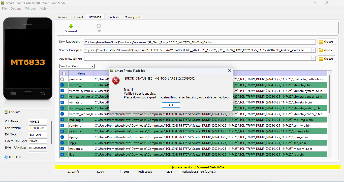

Good day everyone . i really need some help. i got a tcl 30 xe phone to unlock for someone.  i tried removing frp  via samfirm tool (there is a mediatek section) upon restarting the phone the secure boot fail error comes up and the phone is unable to go past the boot logo. i tried unlocking the bootloader with the Sam firmware tool but no luck. i could boot the phone in recovery but only three options is there: wipe date, reboot phone and power off. i also downloaded android utility to try to disable dm verity but no go. i have downloaded firmware for the device one is tmobile and the other is boost mobile. however when i try flashing the vbmeta files, i get secure auth failure.. need a valid certificate file. i am at a lost as what to do next.

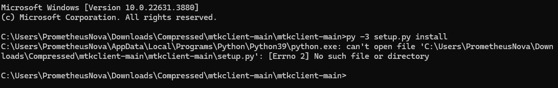

thanks for replying but i can't get this mtk client running. when i reach the step to install setup.py python is saying no such file or directory.. i am running command prompt within the mtk client folder.

(09-07-2024, 07:47 PM)spanish2 thanks for replying but i can't get this mtk client running. when i reach the step to install setup.py python is saying no such file or directory.. i am running command prompt within the mtk client folder.
Try this command
py -3 setup.py install
Ensure to run it in the MTK client folder

10-07-2024, 02:59 PM

(10-07-2024, 09:46 AM)justshez
Try this command

(10-07-2024, 02:59 PM)spanish2 thanks for all the replies thus far. i have gotten a utility called MTKClient GUI 2.0 which works very easily. i flashed the firmware files... however i still get the secure boot fail dm verity corrupted error.  i emailed TCL to see if i can get the correct firmware. also i had purchased a rom from romdevelopers.com that includes the scatter file. However this rom looks like it's for the boost mobile version (they could of specified that before i purchased it.....waste of money) i have three roms downloaded. none worked when i flashed them. always phone remained blank no power. i left it overnight and when i woke up this morning it powered on but with the same error. how hard can it be to fix this dm verity issue. oh i forgot to mention i tried unlocking the bootloader  but that didn't seem to work.
did you try unlocking the bootloader using mtk client?

(10-07-2024, 03:23 PM)justshez
yes i did.. but with the other mtk gui program. i will try again and report back
