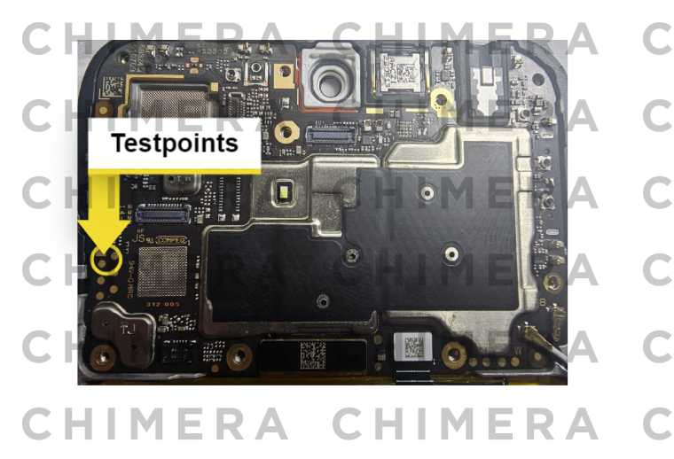

You have to unbrick using EDL and a paid tool. EDL can be entered using test point or an EDL cable
This post was last modified: 01-06-2024, 04:28 PM by maxpayne.
