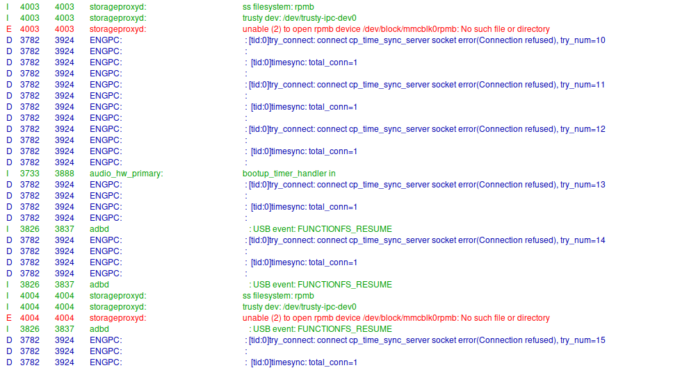

15-11-2023, 08:54 PM
(15-11-2023, 10:57 AM)maxpayne ...
You build the GSI or just downloaded?
Yah, I try flash phh-treble GSI (phh-treble-v222), Google GSI (Google Android 10 GSI) and my own build GSI Android 10 (with debug mode for getting adb logcat, and root)
They're all stuck at booting Android logo.
Please see the attached image, It seems there is a time synchronization error between the vendor and the system image.
I already try to remove some executable file in vendor/bin/engpc , or remove some start command in init.rc file, but still did not work.
I hope you guys may have some experiences in handling the problem of flashing gsi FW for this kind of Unisoc chipset.
I appreciate any of your suggestions to help me overcome this problem
Thank you very much
