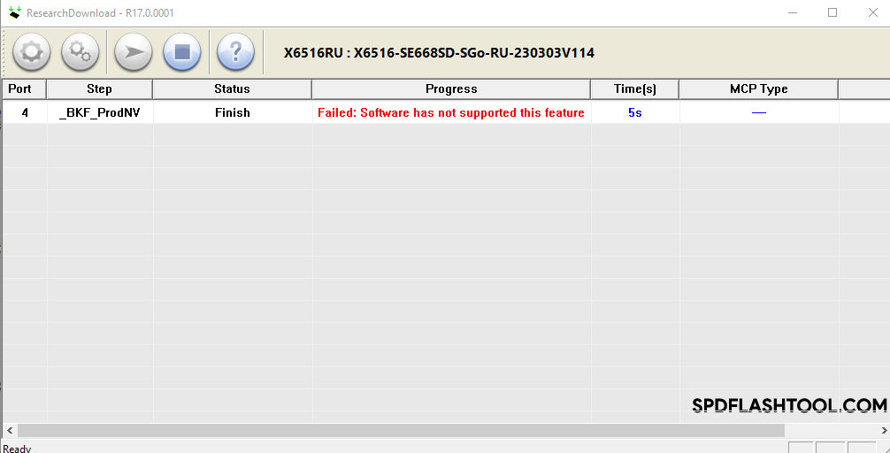

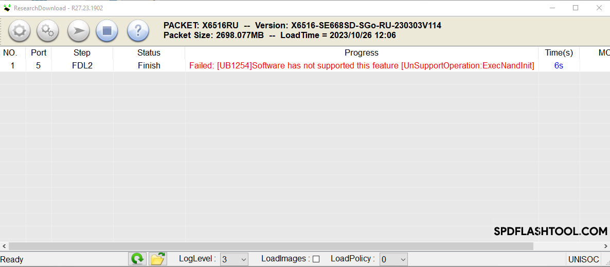

I am trying to flash infinix smart 7 hd (x6516) powered by a (UniSoc 9863a) chip, with SPD Upgrade/Research Tool but it didn't work it gives me this message
Software Has Not Supported This Feature UnspportOperation:ExecNandlint.
is there any solution? or any other way to flash without spd upgrade/research tool for this device?

Failed: [UB1254]Software has not supported this feature [UnSupportOperation:ExecNandInit]
What is your current build number? Try version R25.20.3901 and share screenshot of error

it shows me this message the data packet with type(0x96) returned was misformated
[Image: cNXGpG6.png]

(01-11-2023, 05:33 AM)FenixOs5 it shows me this message the data packet with type(0x96) returned was misformated
Use Factory Download R27.23.1902 and give feedback

same error of the software has not supported this feature
V27
[Image: BnAW5T5.png]
v17
[Image: XGFPRxC.png]
