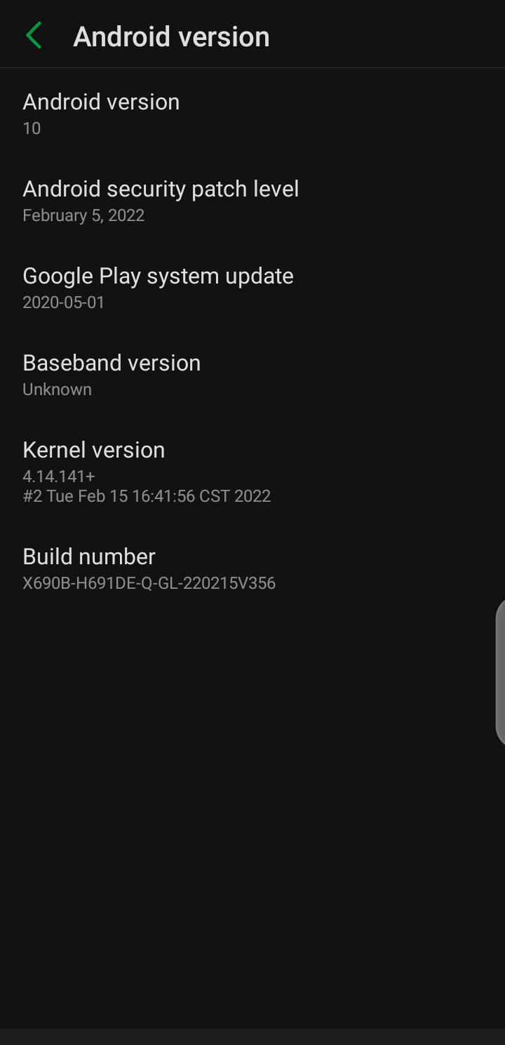

Hello, my I checked my Infinix X690b and the build number "X690B-H691DE-Q-GL-220215V356" then when I did the "get var all" command this was shown to me as boot loader:
(bootloader) version-bootloader: x690b_h691-d08b9eee1-20210223144205-202
version-bootloader: x690b_h691-d08b9eee1-20210223144205-20220215164320
I have been using zip stock-rom files that ends with " V356" ( as shown in my build number) to flash my phone using MTK client or SP Flash tool, but the "Unknown Baseband" no gree fix.
Could it be that I have been using the wrong stock files to flash the phone?
Please can someone explain this to me? I am still finding ways to fix the unknown baseband issue my phone developed

(05-09-2023, 07:22 PM)Khey Worthwhile Hello, my I checked my Infinix X690b and the build number "X690B-H691DE-Q-GL-220215V356" then when I did the "get var all" command this was shown to me as boot loader:

Its a valid question and you didn't state why in this very post so you can't blame anyone for asking the same thing over and over. There are so many posts to keep track of.
If it was running on X690B-H691DE-Q-GL-220215V356 before you did factory reset and lost baseband (as a result of only factory reset and not flashing) then you're flashing the right firmware, its just a bug with this model

I would flash firmware of as many build numbers as possible then. One should restore baseband at least
