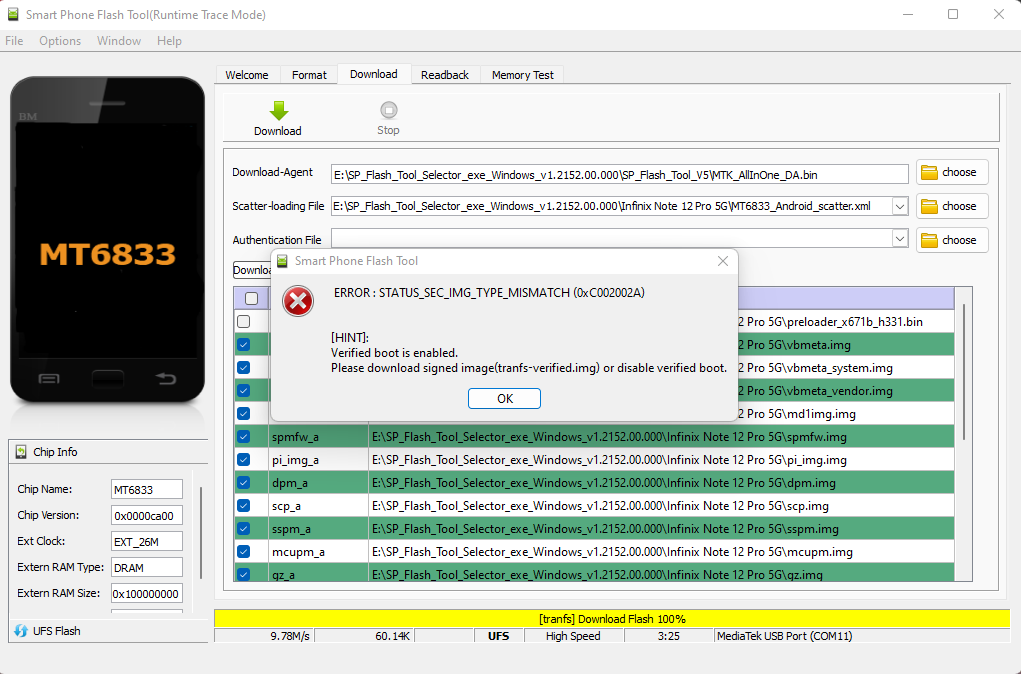

25-08-2022, 02:51 PM
Oddly enough, knocks out an error for tranfs.img:
27-08-2022, 11:04 AM
(25-08-2022, 02:51 PM)ViSet Oddly enough, knocks out an error for tranfs.img:
Skip that and flash the rest.

27-08-2022, 02:51 PM
(27-08-2022, 11:04 AM)hovatek Skip that and flash the rest.
I did so, I'm just interested in the reason for the error: why the flasher doesn't like the tranfs.img.
29-08-2022, 08:35 AM
(27-08-2022, 02:51 PM)ViSet I did so, I'm just interested in the reason for the error: why the flasher doesn't like the tranfs.img.
This sometimes happens when you're not flashing the exact build number you should be flashing. Also the Download Agent plays a part sometimes

29-08-2022, 09:03 AM
(29-08-2022, 08:35 AM)hovatek This sometimes happens when you're not flashing the exact build number you should be flashing. Also the Download Agent plays a part sometimes
Yes, there was a firmware downgrade. The download agent was used universal - MTK_AllInOne_DA, specifically for MT6833 I didn't find on the Internet.
