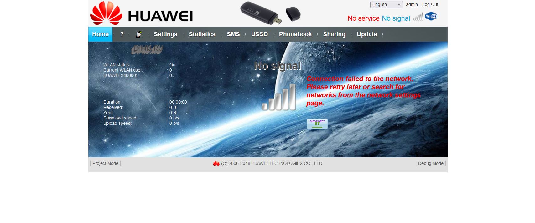

This is a screenshot of the firmware that I was able to install but is the wrong version/bands.
I am willing to pay for someone to make a version of this firmware/webUI that will work on the following 2 models: e8372h-510 && e8372h-609
Any chance of this ^?
I have uploaded the file for the pictured FW for your review. https://file.io/SecJNiGxqNQc

it makes sense now why AT commands worked, because you were on a firmware with AT enabled. firmwares labelled with U_AT or M_AT are modified to allow AT and extra added features too. i also don't think firmware would affect signal reception though (i might be wrong) but is there a frequency you should get but aren't i.e while using the firmware from h-153?
i think you might want to first try out a different webui on the current h-153 firmware (this will help verify if the webui works on your variant) then you can proceed to test with with the other 3 firmwares you listed above. i want to believe that any webui for e8372 should work
webui @ https://www.mediafire.com/file/8lcs9bjly...1.zip/file
h-608 (not sure of it's contents but you can also check it out, it shares some bands used by h-510) @ https://www.mediafire.com/file/dmxd2x0dd...y.rar/file
