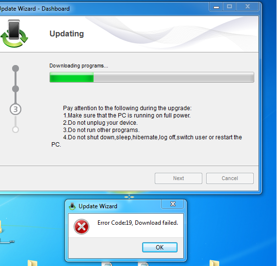

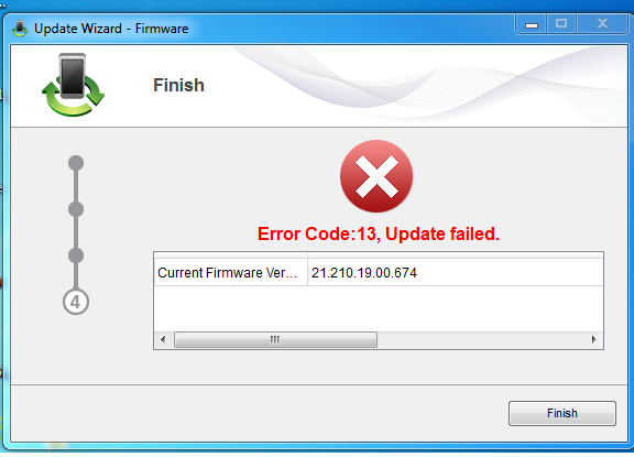

My problem is i cant sofwareing my modme
Can help me the problem in pictures

(15-06-2021, 12:28 AM)hussamdj My problem is i cant sofwareing my modme
you need to either flash usbloader or usblsafe (preferably) using balong before you can flash firmware
there's a usbloader within the firmware @ https://routerunlock.com/download-firmwa...-universal

(16-06-2021, 03:49 PM)X3non
i Want this version?
21.210.19.00.674
How do I get it

(17-06-2021, 06:02 PM)hussamdj i Want this version?
21.210.19.00.674
How do I get it
you can search online for it, doubt you'll find customized firmwares lying around on the internet anyways
