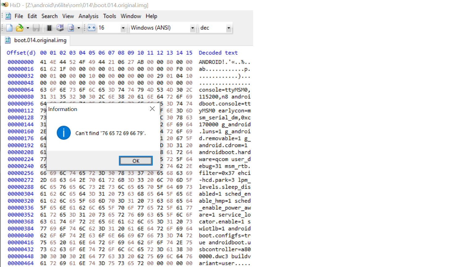

I wish I could benefit from method #1 but there is no 'verify' in stock boot.img, see the screen.

(06-05-2021, 04:24 PM)vpolinov I wish I could benefit from method #1 but there is no 'verify' in stock boot.img, see the screen.
zip and upload your stock boot.img then post the link here
you can upload to any cloud storage e.g gdrive, mega, e.t.c
