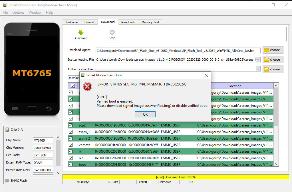

Please help to resolve this matter, in first I have use method "SECURE BOOT DEVICE WITHOUT CUSTOM DA" in Tecno camon 16 CE7J successful , now I need to flash firmware by the same process I get this error (attached in piece joint
I'm waiting for you Hovatek community to help
Thanks in advance
Nota Bene : this attached image is not from my device ( MTK 6768) error message but in mine it's same error message

Flash each files separately

Untick cust and flash the rest

Sorry in PS Flash I don't see where to untick "cust" please more detail

scroll down the list of partitions, you'll find cust
untick the checkbox beside cust then flash the rest

Excuse me to send here all firmware partition in SP TOOL (scatter loading)
1/preloader
2/tkv
3/recovery
4/md1img
5/spmfw
6/scp1
7/scp2
8/sspm_1
9/sspm_2
10/lk
11/lk2
12/logo
13/boot
14/dtbo
15/tee1
16/tee2
17/vbmeta
18/vbmeta_system
19/vbmeta_vendor
20/super
21/cache
22/tranfs
23/userdata
Please teach me witch partition is "cust"

i see the problem now, you attached a screenshot that's not what you are experiencing which indicates cust meanwhile your device doesn't have cust
attach a screenshot of the error message you get and what about @Abdulakeem14's suggestion @ https://www.hovatek.com/forum/thread-388...#pid212585 ?
