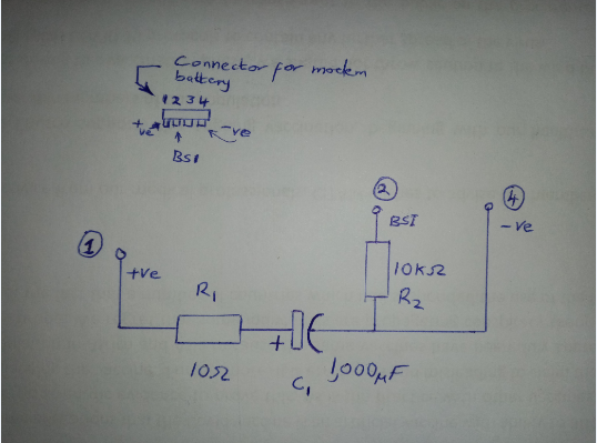

Circuit
[Image: attachment.php?aid=9021]

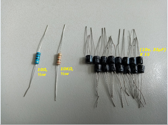

List of components (works with ZTE MF90)
[Image: attachment.php?aid=9022]
The choice of using 15 X (33µF) that are a sweet 4mm by 4mm each in dimension came from the fact that the battery compartment is really minimal and not too many components can be packed inside which fits flawlessly inside any Huawei E55XX modem but doesn't deliver enough startup current to see the modem through the boot cycle but works for ZTE MF90, others get stuck in a boot loop. hence you would need to replace such a bank with a single 1,000µF electrolytic capacitor.
15 X (33µF) = 495µF but the below bank registered 510µF on my R.M.S multimeter most likely due to manufacturer inconsistencies of some being higher than 33µF. I couldn't find any of this size that were 66µF which would have been perfect for this project (no back cover mod needed as will be seen much later in this tutorial)
[Image: attachment.php?aid=9023]

The connections are done with the below pictorial guide. Duly note pin 3 is never used in the battery connector terminals. The resistors have been covered with heat shrink to avoid shorting or malfunction:
[Image: attachment.php?aid=9024]

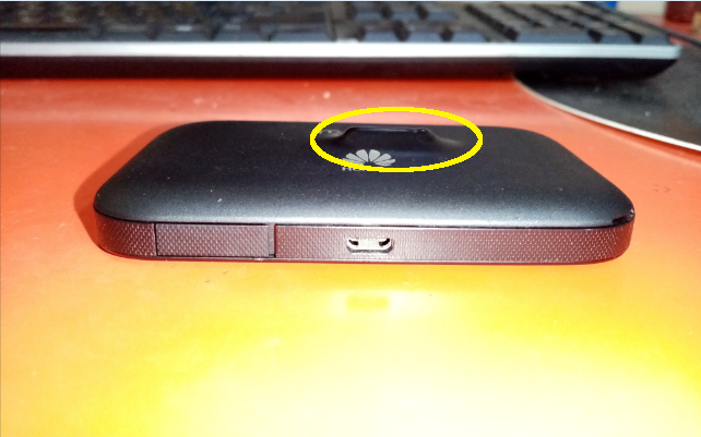

The best spot is usually on the center spot on inside of the back cover. It normally has the widest area for any component that's to be housed inside the battery component and is far from the clip on fasteners on the back cover hence they won't be deformed rendering the back cover useless. When heating the surface of the area to form a pocket on the modem cover, once you notice a change from a matte finish to a shinny sheen surface as you heat it, quickly press the capacitor in with pressure from your fingers surrounding the capacitor all around it on the flat even surface until the edges of the back cover touches the even surface (in my case the red surface shown) all around without any part lifting in any side or corner, do this repeatedly if it doesn't fully form with one try. Also note that the back cover will be hot so you might need some thermal gloves if you are sensitive to high heat. This is to ensure the clip on fasteners won't get overly stressed by the capacitor when you try to close it in with the back cover. The idea is to form a depression pocket on the inside of the back cover that allows the extra size of the capacitor to be locked into the battery compartment without any stress as seen below:

I guess it's a small price to pay aesthetically but the gains are greater than the losses when you can actually get a 20,000mAH battery and spend 2 weeks in remote areas with absolutely no signal/performance drop or worry about running out or the battery swelling. You also do not tamper with the firmware hence it remains intact and compatible as before with your carrier.
I have mine suspended on a phone holder as it powers off a charger hence the capacitor bulge isn't an issue and especially that it's matte black hence it isn't that noticeable. Should the need arise to have the back cover return to its original flat shape, just heat the surface evenly with the hot air gun, it will automatically return to its original flat even shape, I had this experience while trying to form a deep enough pocket for the capacitor at the 2nd and 3rd try.

If the modem flashes battery error codes, it's likely your R1 and R2 are swapped or mismatched in connection or pin 3 has been used or there is a dry joint in your circuit. Take the circuit apart and test for proper connectivity and contact.

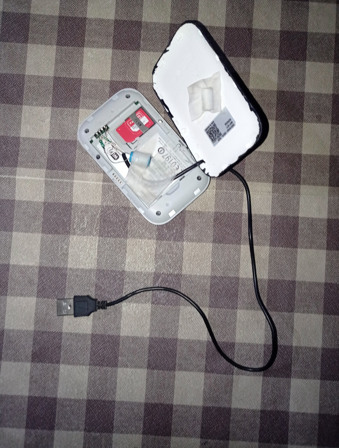

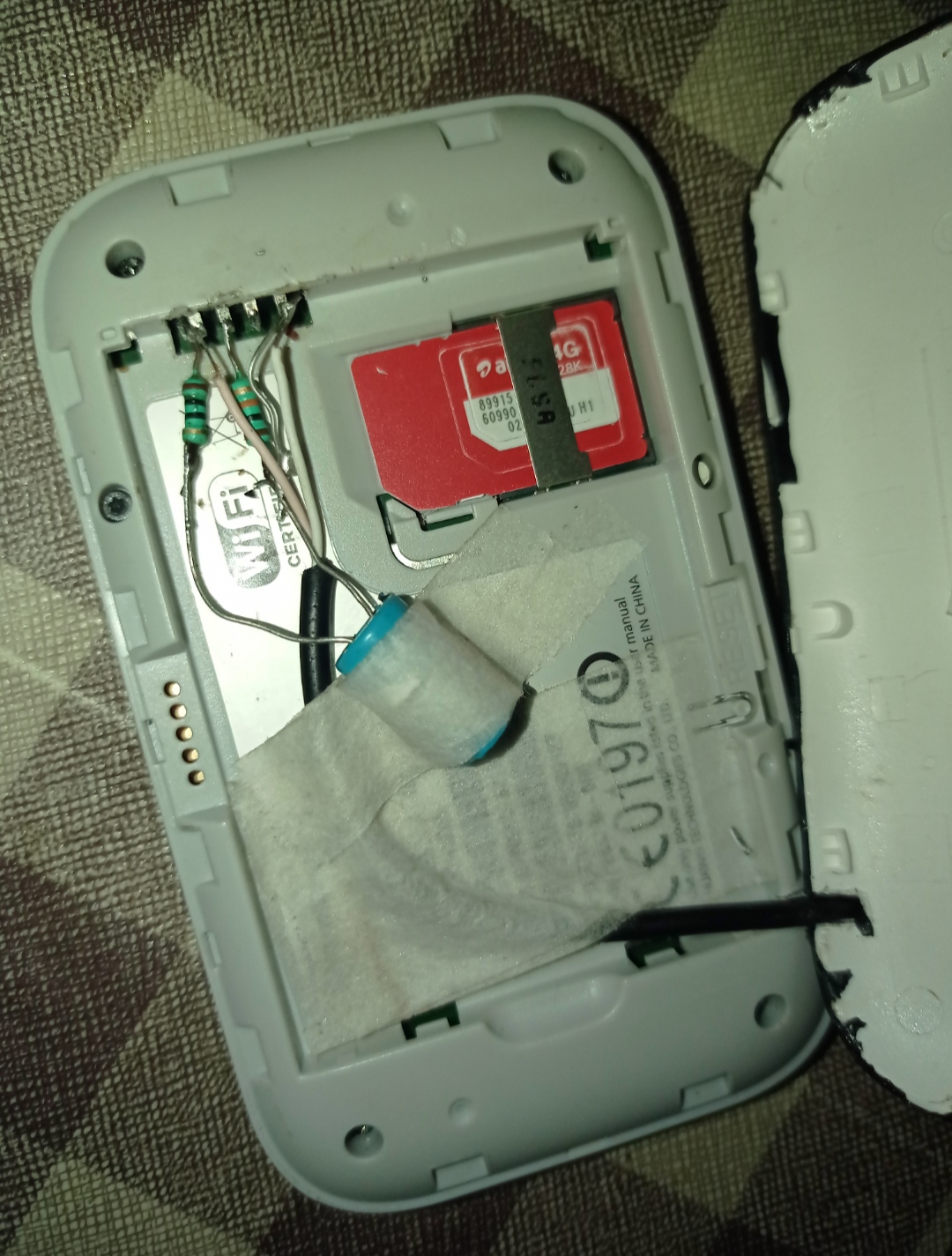

Thank you for sharing Smile Also I did a little bit of modification. I wasn't getting enough power to keep the E5573s running, so all I did was I soldered a usb cable to the +ve and -ve pins. And it works Smile
I have attached my modification. Hope it helps.
