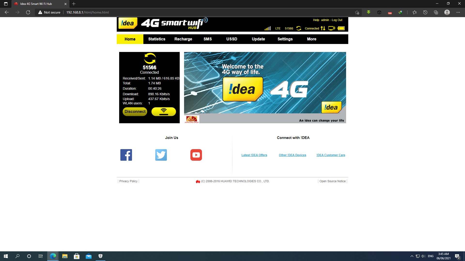

05-06-2021, 08:42 PM
(04-06-2021, 12:25 PM)X3non
(03-06-2021, 06:31 PM)RKY TV do you have stock web ui of huawei for e5573cs-931? Thanks would appreciate that.
the same webui above would work for your model, any webui for e5573
sir it wont install its said error. the one that i installed is the india web ui which is i dont like. i just want he plain web ui of huawei. thanks.
this is my firmware version.
Software version: 21.318.05.00.00
Web UI version: 17.100.15.01.356
attached is my web ui. i want a stock huawei one. thanks.
This post was last modified: 05-06-2021, 08:46 PM by RKY TV.
51,035
07-06-2021, 10:16 AM
(05-06-2021, 08:42 PM)RKY TV sir it wont install its said error. the one that i installed is the india web ui which is i dont like. i just want he plain web ui of huawei. thanks.
use the same procedure you used to flash the idea webui
i.e flash usbloader or usblsafe first, if you flash usbloader then you'd need to flash firmware and webui, if you flash usblsafe then you only need to flash the webui
This post was last modified: 07-06-2021, 10:25 AM by X3non.
RKY TV
RKY TV
RKY TV
8
07-06-2021, 03:08 PM
(07-06-2021, 10:16 AM)X3non
sir thanks for that info that ill use the usblsafe to flash web ui. i was confused what to used to flash web ui at first. thanks a lot.
