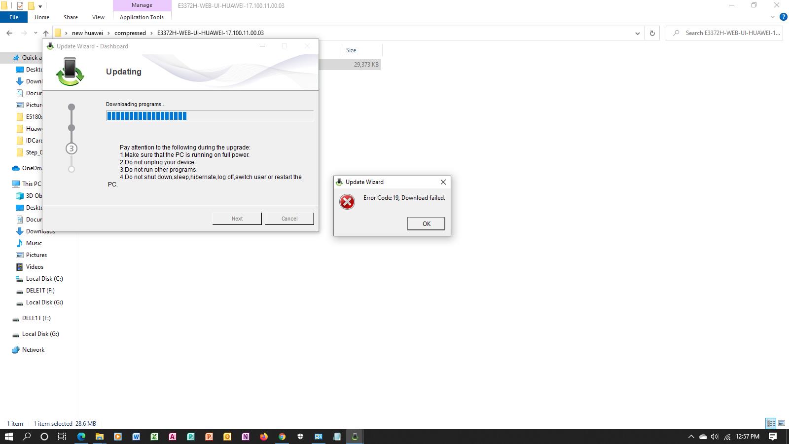

But still got a problem when I try installing WebUI. kindly find attached image

(02-04-2021, 01:14 PM)deeman Thanks for the assist and I am impress with the response.
webui for e3372 on e5180? doubt that'll work
[/quote]
Any suggestions please. cant access the Web Interface and as such cant configure the Wifi and APN. would appriciate the help.
05-04-2021, 12:50 AM
(03-04-2021, 03:38 AM)deeman Any suggestions please. cant access the Web Interface and as such cant configure the Wifi and APN. would appriciate the help.
you'd have to search online for this
any webui for e5180 should do

Alright... Been able to load another WebUI 16.100.03.00.03
But that was after loading firmware 21.270.25.00.00 and now my device is sim looked again find attached image.

interesting, so a different e3372 web-ui worked, good work
can you post the link to the web-ui? it could help someone else who stumbles here
