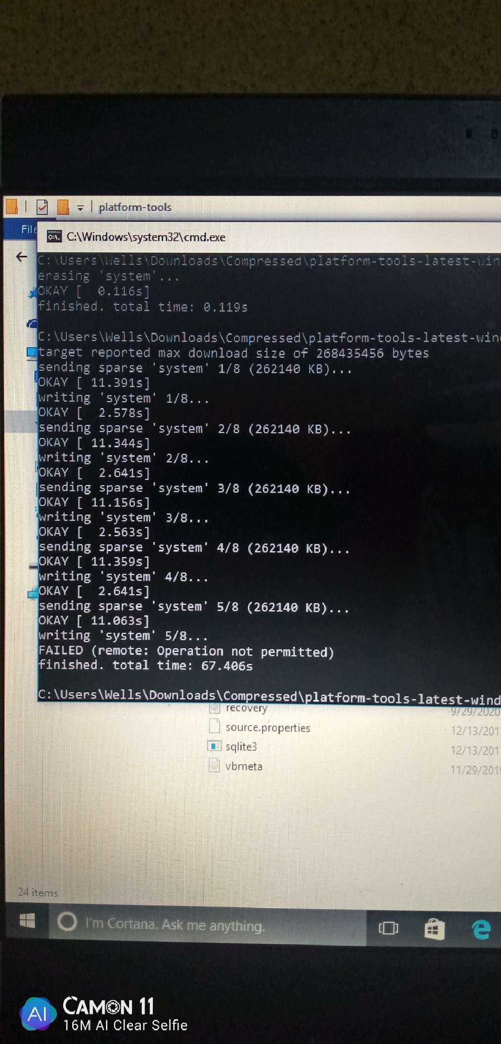

Hello sir, i purchased a oukitel C21 device having Android 10 out of box. The stock rom is stock android based. Am an advance user, i unlocked the bootloader, disabled verified boot. I have read up on the usage of fastbootd mode on android 10 devices, i was able it to setup up correctly..
But now is the issue, in fastbootd mode, i used the command 'fastboot flash system havoc.img'.. The installation begin . and sparse image is been loaded into the phone.. But at the middle of the operation. It returned a error message ' Failed (remote: Operation not permitted) '.. I have tried with different Gsis but all is the same.

i hope you were using the latest fastboot, you can get this from latest platform tool, check @ https://www.hovatek.com/forum/thread-17104.html
