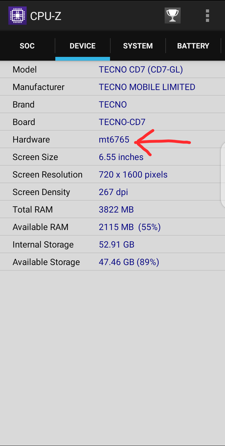

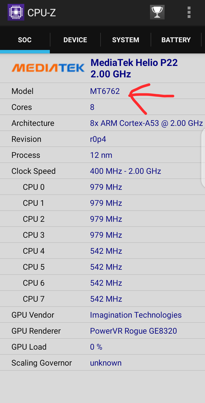

I used CPU-Z & Device Info HW app to know my chipset. I know my Chipset is Mt6762 which is Helio P22 but from the stock firmware i downloaded online for my rom from hovatek as well as other sources all have a MT6765 scatter file which is Helio P35..I am trying to dump my stock rom using Wwr+SP Flash Tool from this guide : https://www.hovatek.com/forum/thread-21970.html but i dont know which chipset to use , should i use the MT6765 or i manually add MT6762? I have attached screenshots of CPU-z below.
UPDATE : I added my chipset following the guide above but when i use that scatter file it says " Platform MT67 not support on this version.Please update to latest flashtool and try again". I m already using the latest flashtool version and i have some other older versions too. They all are showing same error.

(08-03-2021, 09:32 AM)FlexxingOff I used CPU-Z & Device Info HW app to know my chipset. I know my Chipset is Mt6762 which is Helio P22 but from the stock firmware i downloaded online for my rom from hovatek as well as other sources all have a MT6765 scatter file which is Helio P35..I am trying to dump my stock rom using Wwr+SP Flash Tool from this guide : https://www.hovatek.com/forum/thread-21970.html but i dont know which chipset to use , should i use the MT6765 or i manually add MT6762? I have attached screenshots of CPU-z below.
all mt6762 uses mt6765 scatter
when adding chipset to wwr, don't include the trailing alphabets i.e just add mt6765. better still download and use v2.51 mt6765 is already included
