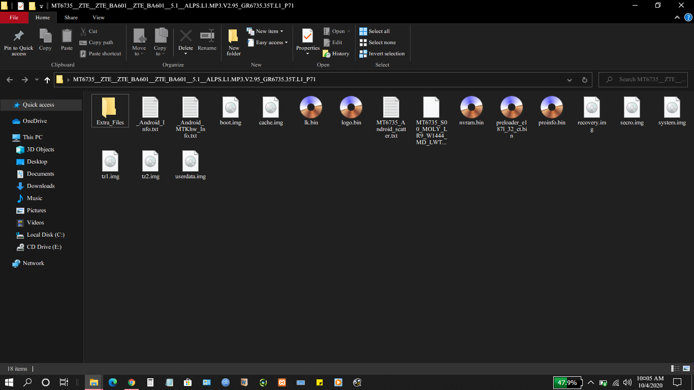

Hello hovatek , please i am still having issue with my phone zte ba601 (I don't even know if that is even the make of the phone) ... when my brother gave me the phone it was showing tecno when I turn on the phone but the phone settings is showing ZTE A8 android version 6.0 and it was very slow and hanging so I downloaded and flash
MT6735__ZTE__ZTE_BA601__ZTE_BA601__5.1__ALPS.L1.MP3.V2.95_GR6735.35T.L1_P71
rom with sp flash tools and it was showing zte when I on the phone, no more tecno again .... the phone was working well but after sometime it was saying this app and that app have stop working so I did factory reset in recovery mode but it only show the zte logo and will just stay there so I flash this
rom again the same thing it is stuck in that zte logo so I did format and download with the sp flash tool the phone is not coming up, it cant boot to recovery and not responding to power button ... it is only charging ,,, showing red light ..... if I connect it to system it will make sound ..... disconnect and connect again ... it is showing as mediatek preloader or mediatek USB something .... i have try to charge it for a long time but it is not coming up ... me I don't no what to do again...... i have search for tecno a8 rom i cant find it.... me I don't no what to do again

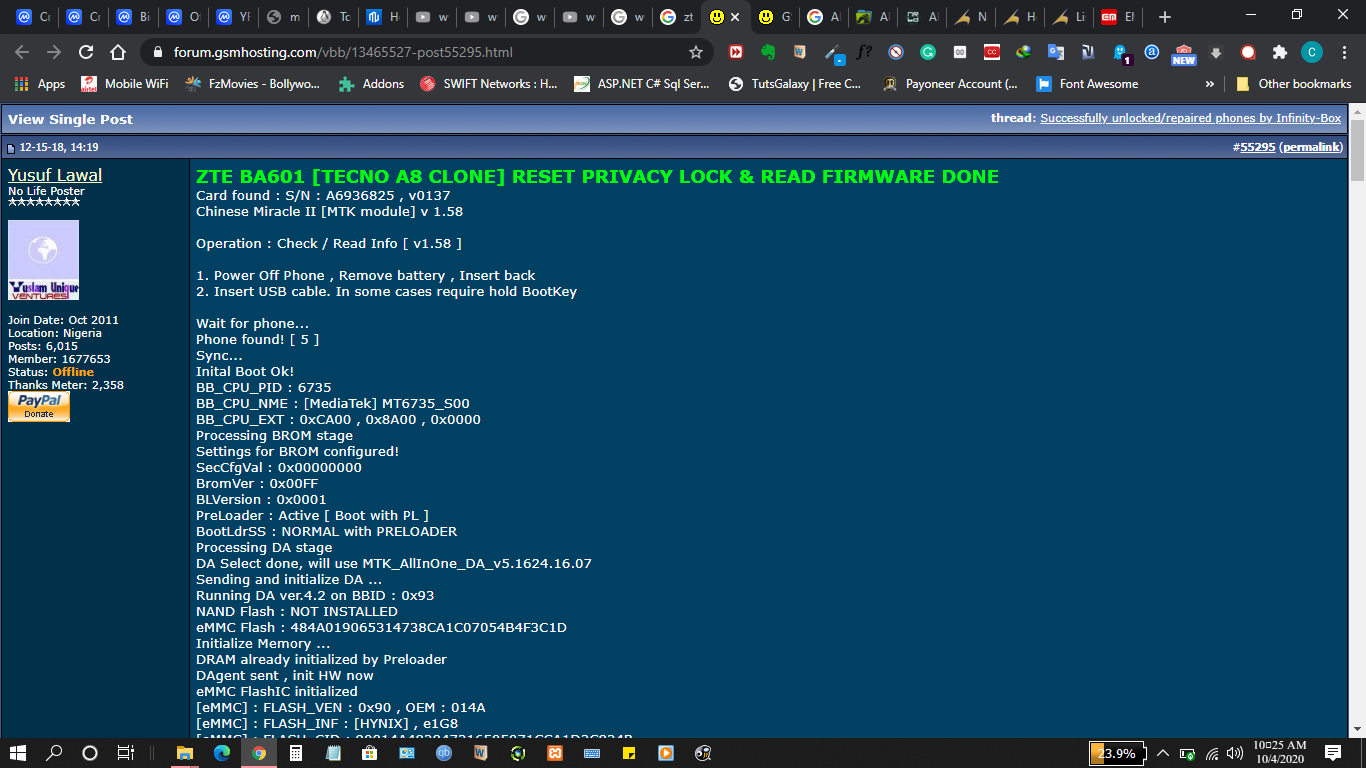

check link may provide some info https://forum.gsmhosting.com/vbb/1346552...55295.html

try flashing only preloader i.e untick the other files asides preloader in sp flash tool then flash
if its successful, then tick the rest and flash

seems like faulty emmc
retry flashing with and without the battery, also try a different usb cable and different pc if possible
