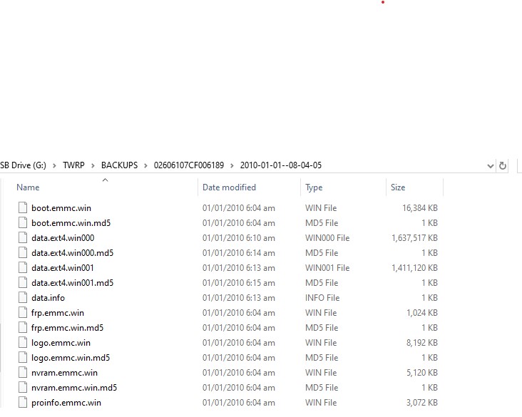

But I have a problem with restoring part of the backup I did with miracle box. After flashing the userdata.bin file it flashed successfully, the phone wasn't booting for long period of time and gets stuck at the Tecno logo. So I had to to a factory reset with the stock recovery, flashed twrp recovery back then I used the backup I did with twrp. It restored my apps and data but didn't restore media files because twrp doesn't do backup internal storage media files. Is that userdata.bin with miracle box file backup I did containing media files in internal storage backup?  Or is there a way I can recover them?

(26-07-2020, 11:42 AM)DivergentSony ... Is that userdata.bin with miracle box file backup I did containing media files in internal storage backup?  Or is there a way I can recover them?
yes it contains media
you could try to flash it back along with twrp, then use twrp to manually copy the files to a different storage but i guess that's too late

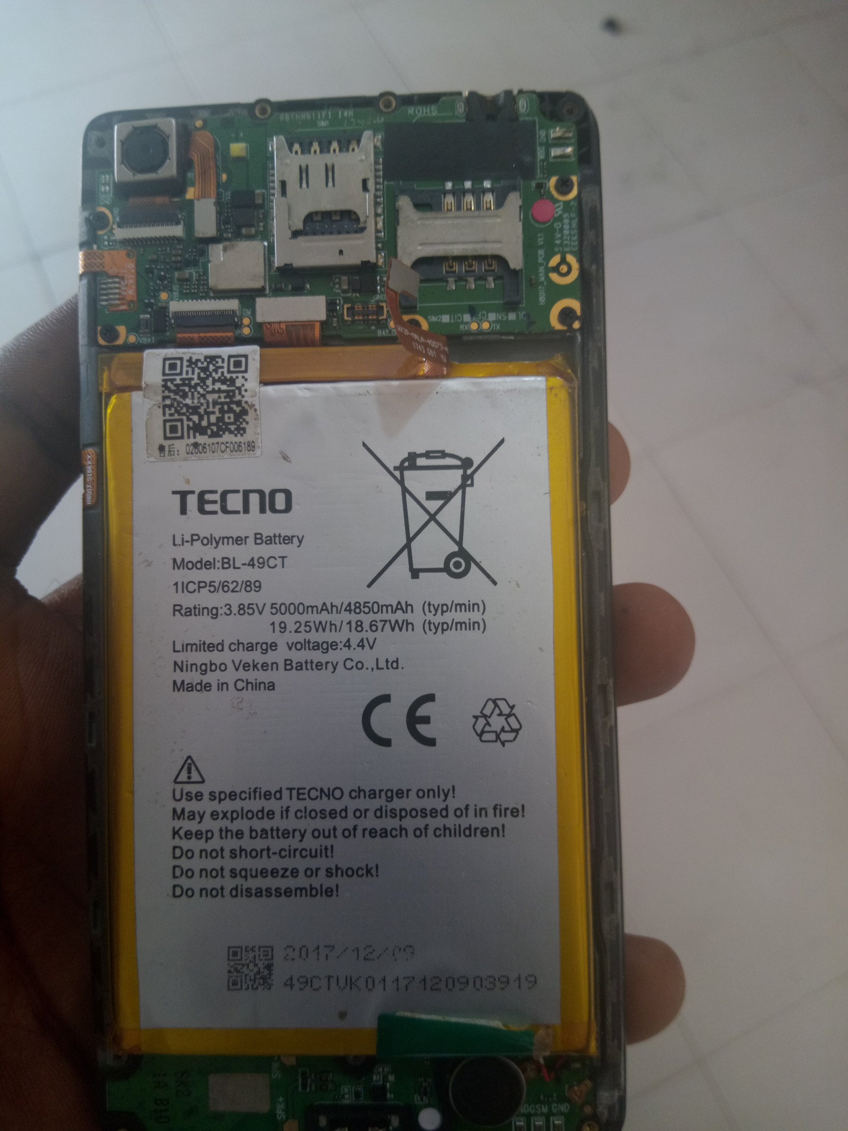

(26-07-2020, 11:58 AM)DivergentSony Then secondly. Another issue just occured today. I did the flashing on thursday night and started using the phone on Friday after flashing magisk to root it, restored backups and all that. So the phone was working fine since then until early hours of this Sunday morning. I was charging the phone yesterday night and I was working on my system. So around past 12 this morning, I was feeling dizzy and decided to sleep and I think the last battery percentage I saw it last before I slept was around 75%. When I woke up this morning around 6am and tried to switch it on it's not coming up. I set the phone to auto switch off 5:15am everyday, so I think it did just that.
But the issue now is powering it, It's not even vibrating self. I don't know why it's not powering up because I think the battery should be full and it's not low battery that's causing it. I've tried plugging my charger to it for more than 2 hours minutes but it's only showing the blue light indicator that indicates it's charging, but the screen is not coming up to show the charging interface. Pls how can I fix this? ...
have you tried disconnecting / reconnecting the battery of the device?

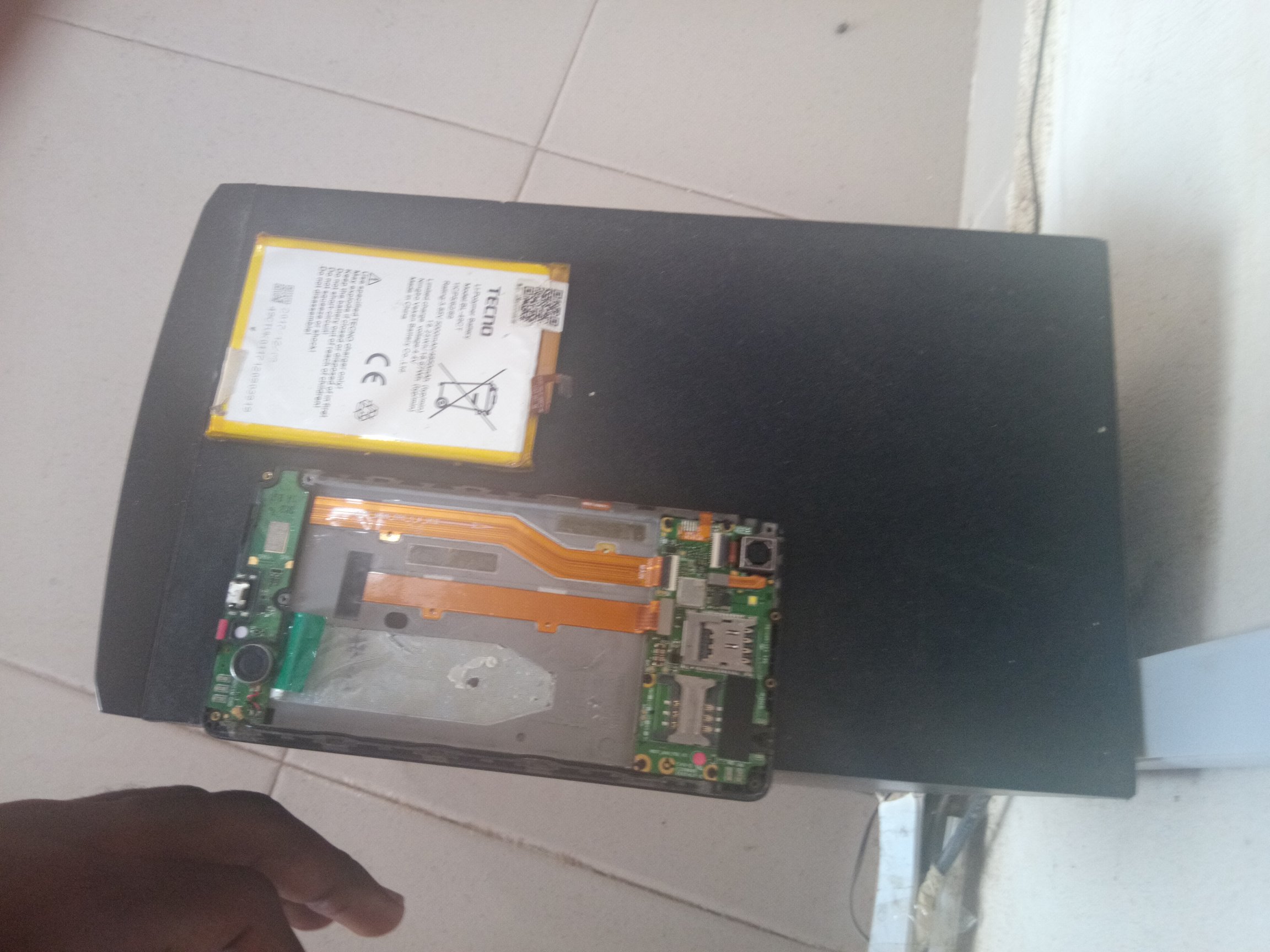

Yes I did that, I've loosed the phone. I disconnected it and plugged it back. But it's the same thing.
I attached the pictures below.
Another discovery I made while doing that is that when I plug the charger, if I disconnect the battery flex, the charging blue light indicator remains. But if I disconnect the 1st flex that's by the left hand side, the charging indicator goes off. I don't know if that implies anything that can help me detect a solution to it.

51,003
28-07-2020, 09:43 AM
#17
(27-07-2020, 10:37 AM)DivergentSony Yes I did that, I've loosed the phone. I disconnected it and plugged it back. But it's the same thing.
it's likely the emmc chip is faulty
look for a cm2 dongle, then perform an emmc test using the cm2mt module
