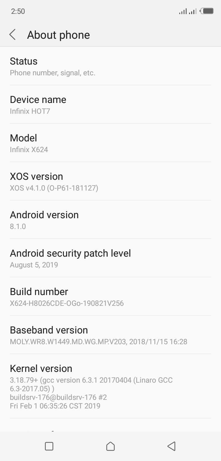

Have tried to root infinix hot 7 x624 go edition but failed, it has a different build number and its firmware can't be found anywhere. kindly check the attached image and help.

(11-05-2020, 06:50 AM)munemugo Have tried to root infinix hot 7 x624 go edition but failed, it has a different build number and its firmware can't be found anywhere. kindly check the attached image and help.
backup firmware from your device @ https://www.hovatek.com/forum/thread-21970.html , you can use miracle thunder if you wish
DA file @ https://www.hovatek.com/forum/thread-23339.html
after backup is successful, root using the guide @ https://www.hovatek.com/forum/thread-21427.html
